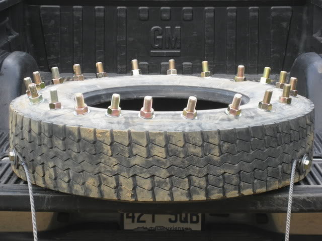

here is a pic

Bcp, that is a briliant innovation and incorporates the principle of the chain harrow's tines. Must be a pain (without the proper tools) to bore through if using a steel-belted radial, but the concept is great. Aren't we a clever species!
Good stuff.
