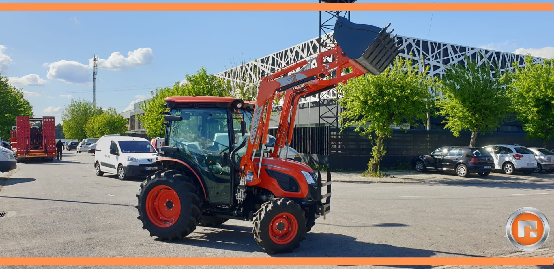

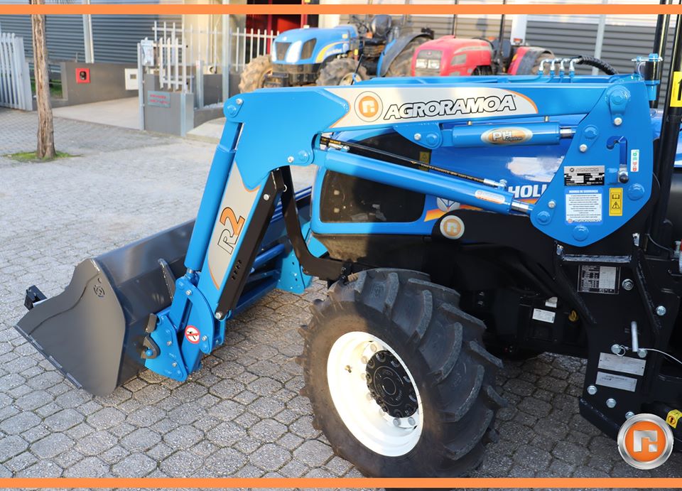

I have a feeling the curl cylinders will be a tad longer for a self leveling loading though. You'll also need a crossover relief valve on the curl circuit, so the cylinders gives under a certain condition and won't bend stuff.
Another alternative is doing a hydraulic self leveling, instead of a mechanical one.
A loader manufacturer here in my country, uses two cylinders mounted above the lift cylinders. These are tied into the curl circuit. Here is a picture of it:
91817471_2852425054853124_1255514095621242880_o.jpg84701935_2735897679839196_5252415557541560320_o.jpg
It seems to work very well as they sell more hydraulic self leveling loaders than mechanical and non self leveling loaders. The trick is figure out the volume needed on these two extra cylinders, so it keeps the forks leveled.

This is a very interesting style. I've seen it on tele-handlers, it's a great way to go, but I have no idea how to determine the volume and no way to tune it later. Need to get this perfect on the first shot! With the conventional overarm style, I figure I can change the triangles if I need to tune it.
/ DIY Mechanical Self leveling loader #9
Totally agree with you. From a fabrication standpoint, the hydraulic route it's easier to make and adapt but harder to figure out, while the mechanical linkage it's the opposite. From what I've seen, the hydraulic one is less prone to have the bucket kinda floppy when in full dump position versus the mechanical one.
