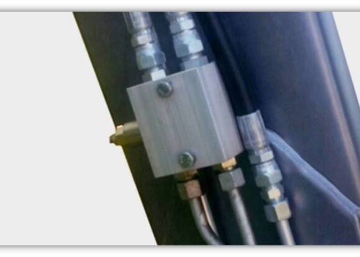

I have heard that the hydraulic leveling valves are not so good? Just wondered if anyone has had any experience with them? This would be installed on a NH TN75 with Stoll HDPM8 FEL.
/ DIY Mechanical Self leveling loader #24
Never used one my self but I've heard several times that they lose position over time and are not that accurate.
The hydraulic self leveling using two small cylinders connected in parallels with the curl cylinders, like I've shown on the first posts, seems to work very well and haven't heard any complains.

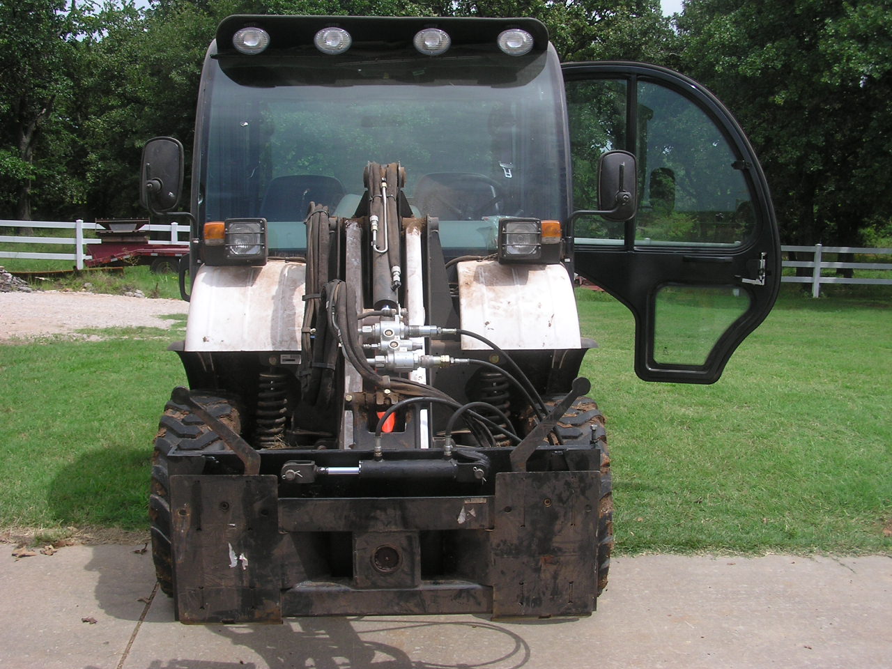

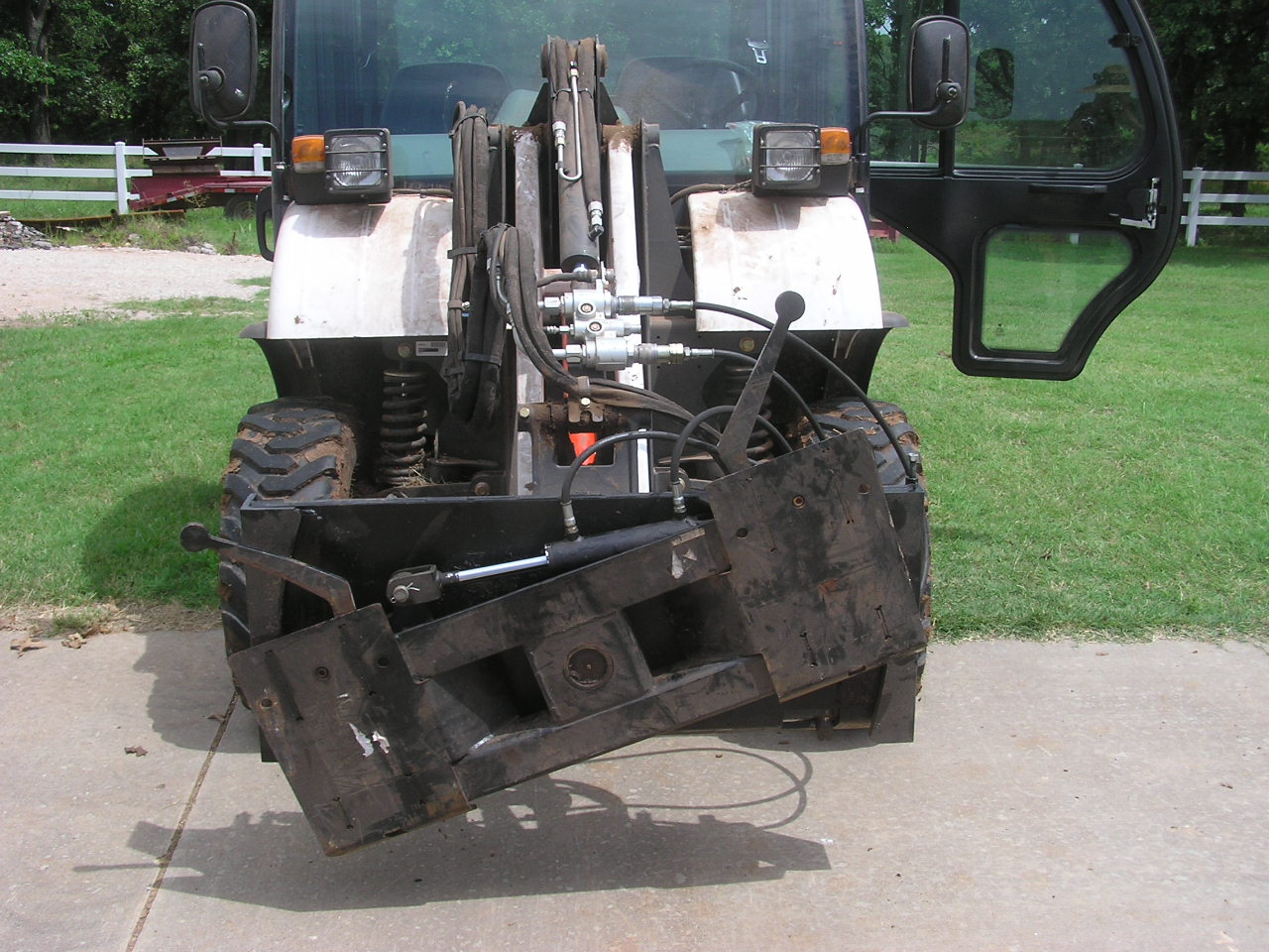

After reading all the posts it seams like half of you are talking about keeping the forks level when lifting a load and the other half are talking about leveling the forks to the ground to pick up a pallet that's on a different plane side to side than the rear axle. My 580K has a front to back leveler that's mechanical. It pushes against the loader's lever as it's raised. I think this would be a much easier way to go. As for side to side, if you have a quick attach set up making one seams like it would be pretty easy. Also, since side to side is really only needed for forks, you could make it so it wasn't part of the loader but attached to the forks.
/ DIY Mechanical Self leveling loader #33

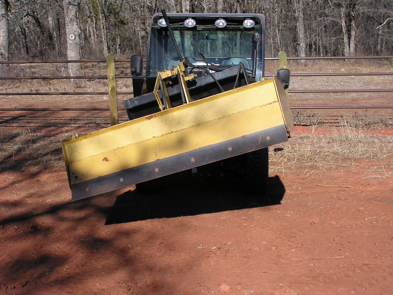

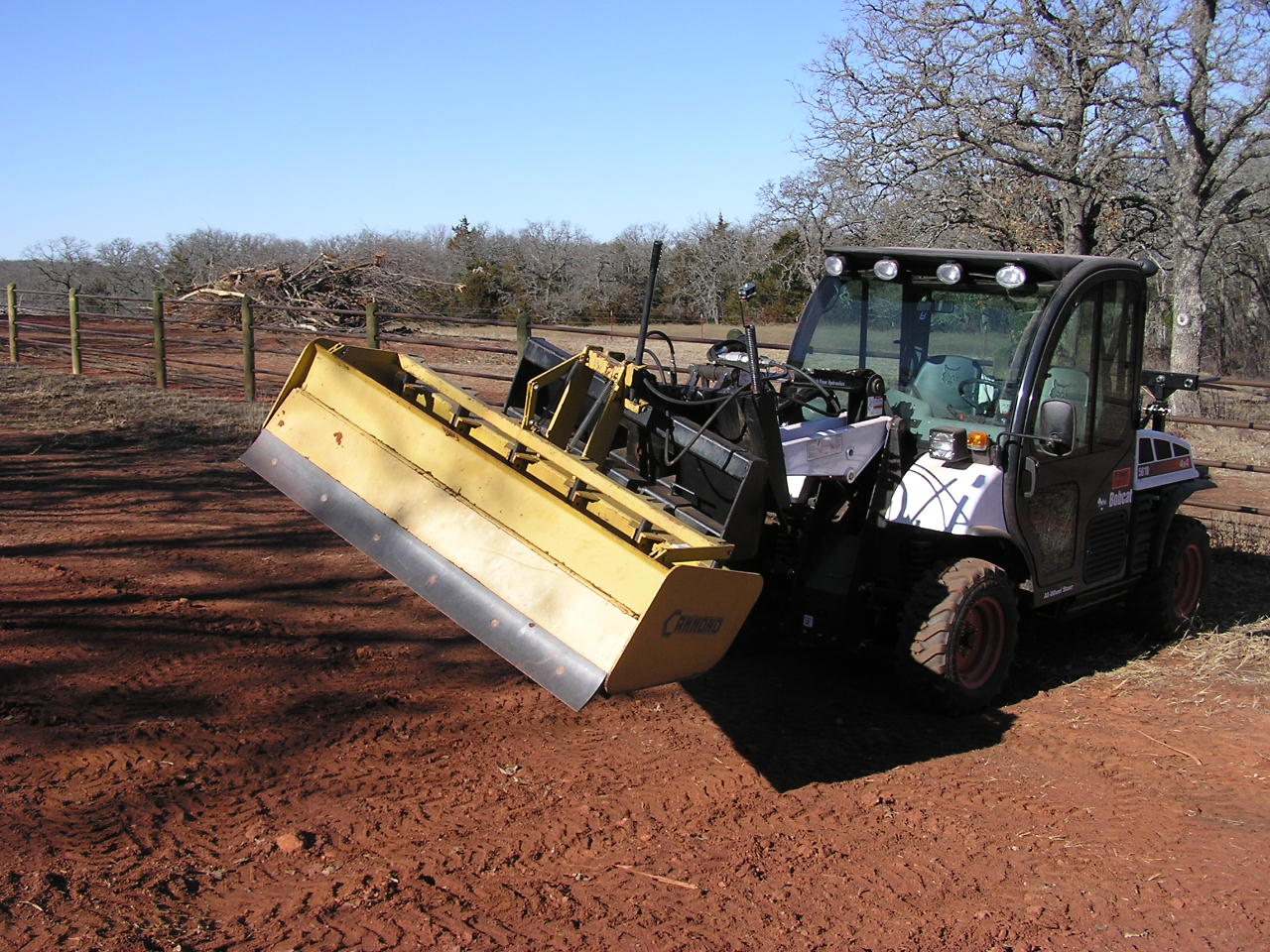

Or buy one that can be used with any SSQA attachment:
I have not needed it for the forks, just the land plane, box blade and bucket:
