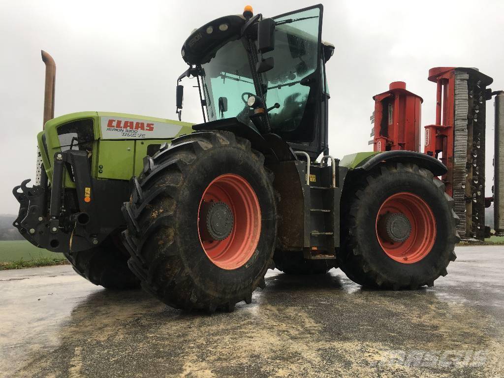

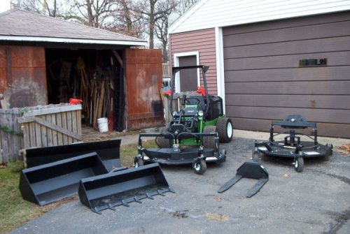

I think we will see a lot of more solutions for small scale farming, so your idea might come to life
Here are so.e pics of a Fendt tool carryer that hase some of you ideas 4118-795013cc098b3c4ef3b14e4ac400ad77-1732305-0vb.jpegimages.jpegFendt-GTA.jpegimages%20(1).jpeg

I wonder what kind of structure would it take mounted on this to support a big bucket up front?
/ DIY platform tractor #5
Don't think they are produced anymore, probably to expensive I think 130hp was the biggest. And with harder rules on pollution the Deutz air-cooled diesel doesn't meet the demand as far as I know. And with this design it has radiators and large exhaust filtering systems would be hard to find space for. And this is a very German thing so the market are limited.
/ DIY platform tractor #6
Think it lifts 2300kg on the front 3pt and 4300kg on the rear 3pt and if I read my German right 1500kg on the tool lift in the middle.
