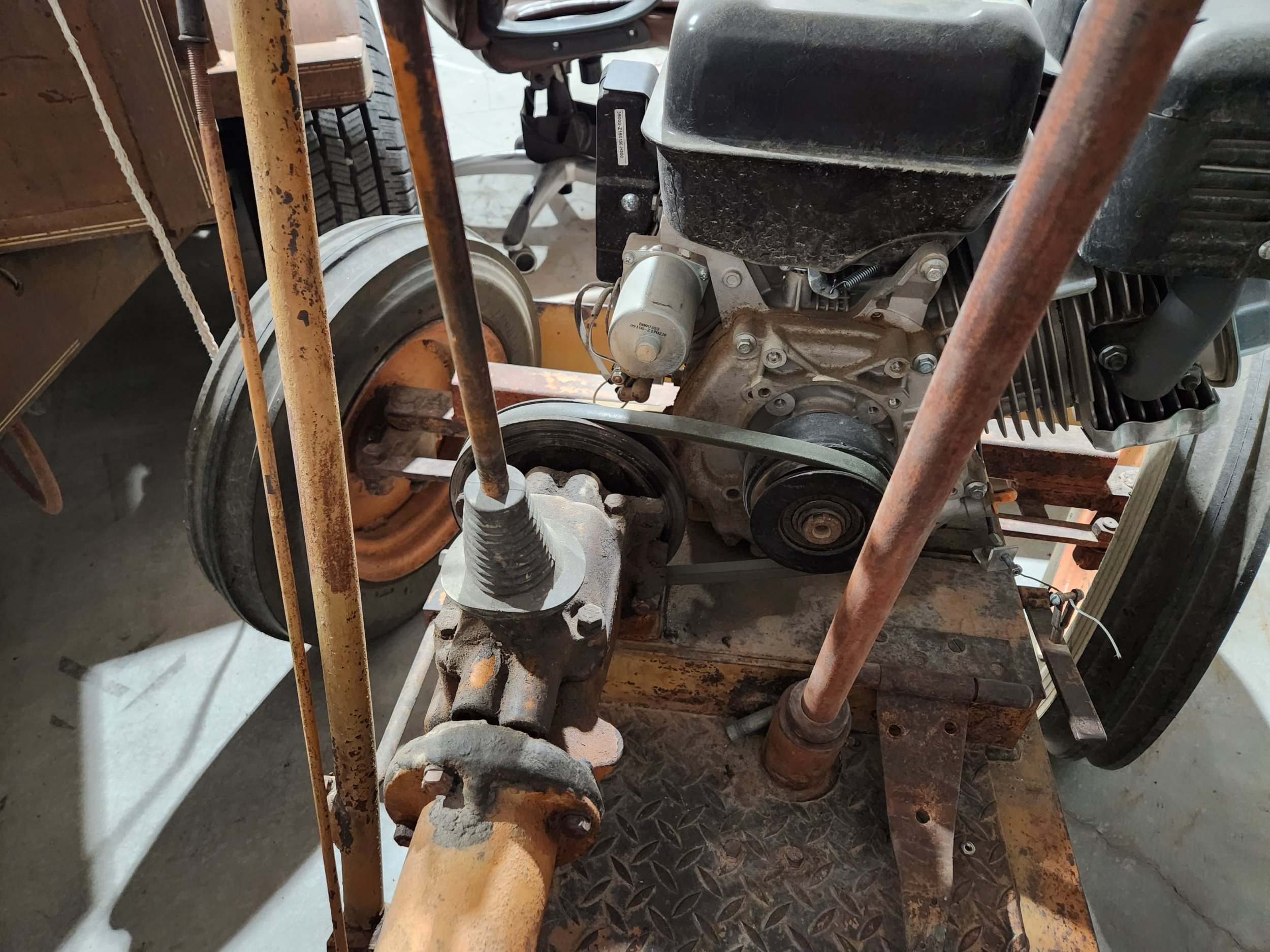

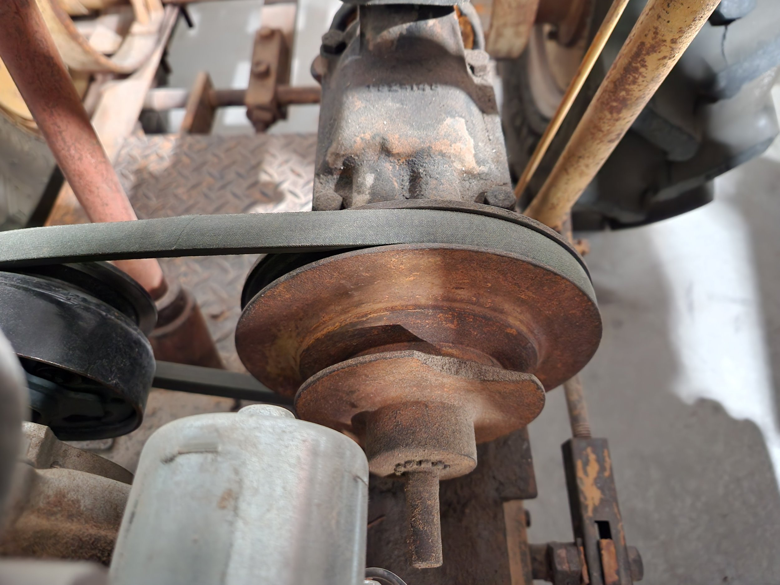

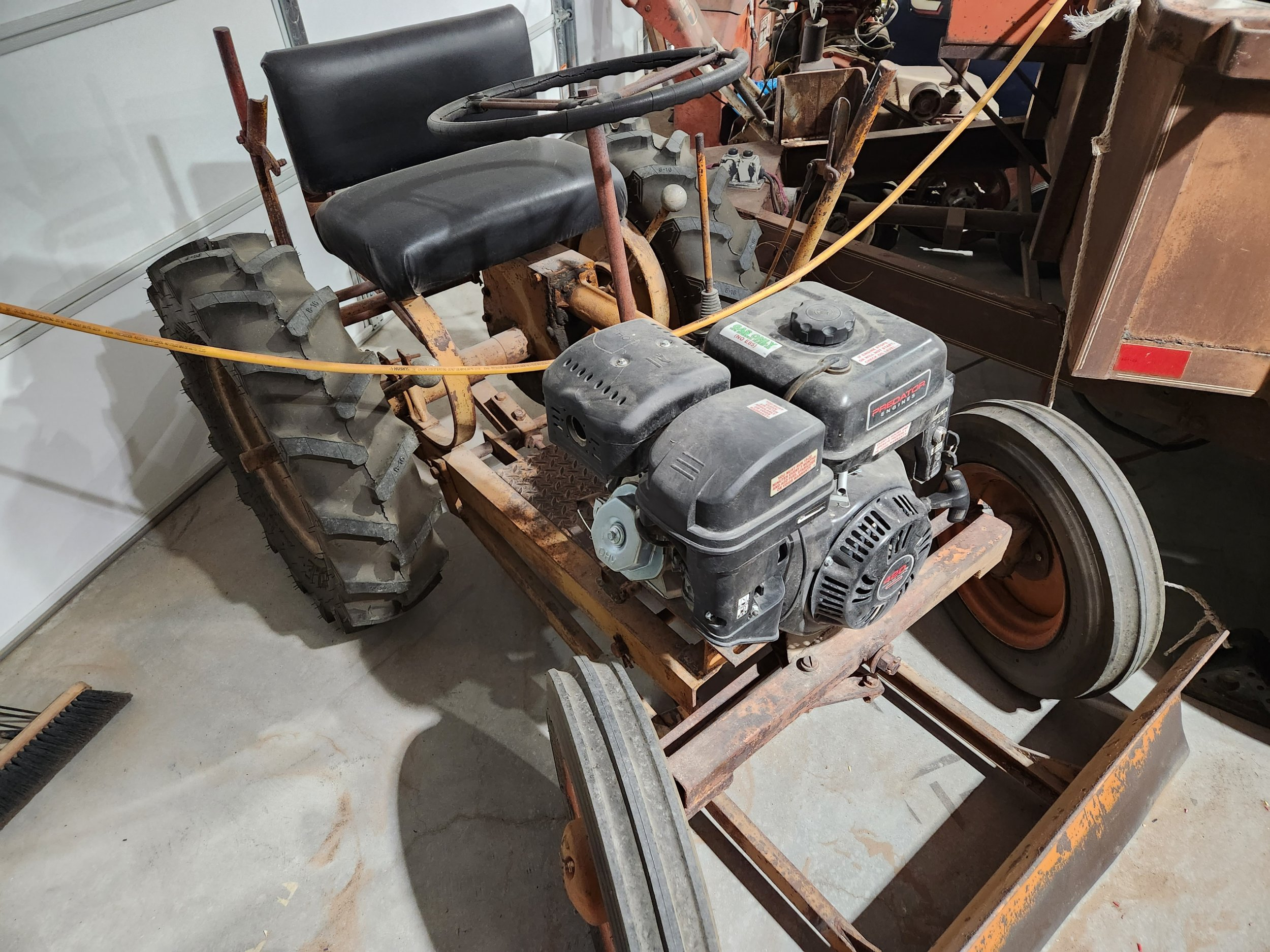

This tractor from the late 40's should give you some ideads.
Also, a small DIY garden tractor is not an uncommon thing to do.
You'll need to shorten a rear, and use some minor machining methods for a pulley, but its doable.
Also, If you can find a 1970's ford with a 'granny low' 4-speed, that should be all the gearing you would need (maybe?)
PTO is the hard part.
Anywho, tractor pictured uses a Crosley transmission, mounted to a custom splined pulley, and a centrifugal clutch.
Wow that belt drive looks really interesting, I was planning on using a hydro off a lawnmower but now a regular transmission is definitely going to be more useful haha. I've found some out of a Ute for a few 00$ which will give me low gearing. As for the pto I'm planning on using a simple belt tensioner system to activate and deactivate. It's 100% not the best, but byfar the safest assuming I'm using a very high hp engine. Since the belt will slip long before anything else gives up. The only PITA part is going to be the tracks/transmission system. Hopefully that's somewhat easy to do however. But sadly next to nobody's done a homemade tractor
