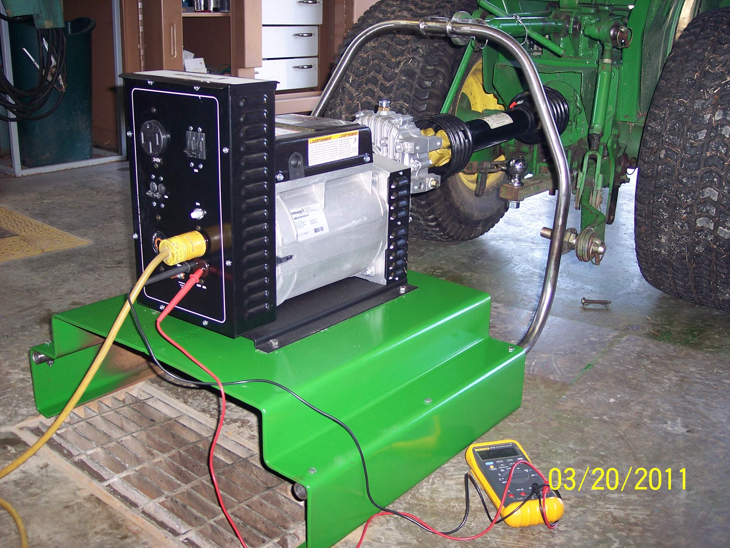

I'd do a geared drive again. You can still get some fab time in welding up a frame and base to mount it on. I drove this 12kw off of a 650 JD. It was only good for about 5 or 6kw but now the 3520 will play with 12Kw. PTO gen.jpg

was your frame a custom bend up job.. or repurposed from something else like a mower deck shell?
just curious.
looks great by the way. :)

I'd do a geared drive again. You can still get some fab time in welding up a frame and base to mount it on. I drove this 12kw off of a 650 JD. It was only good for about 5 or 6kw but now the 3520 will play with 12Kw.View attachment 309402
Where did you source the gearbox and head?

I bent the H.wall SS pipe and 1/4" plate myself. It came from "electric generators direct.com. "
And thanks. I really enjoyed building it and TIG welding the pipe. The frame is actually in 4 pieces.

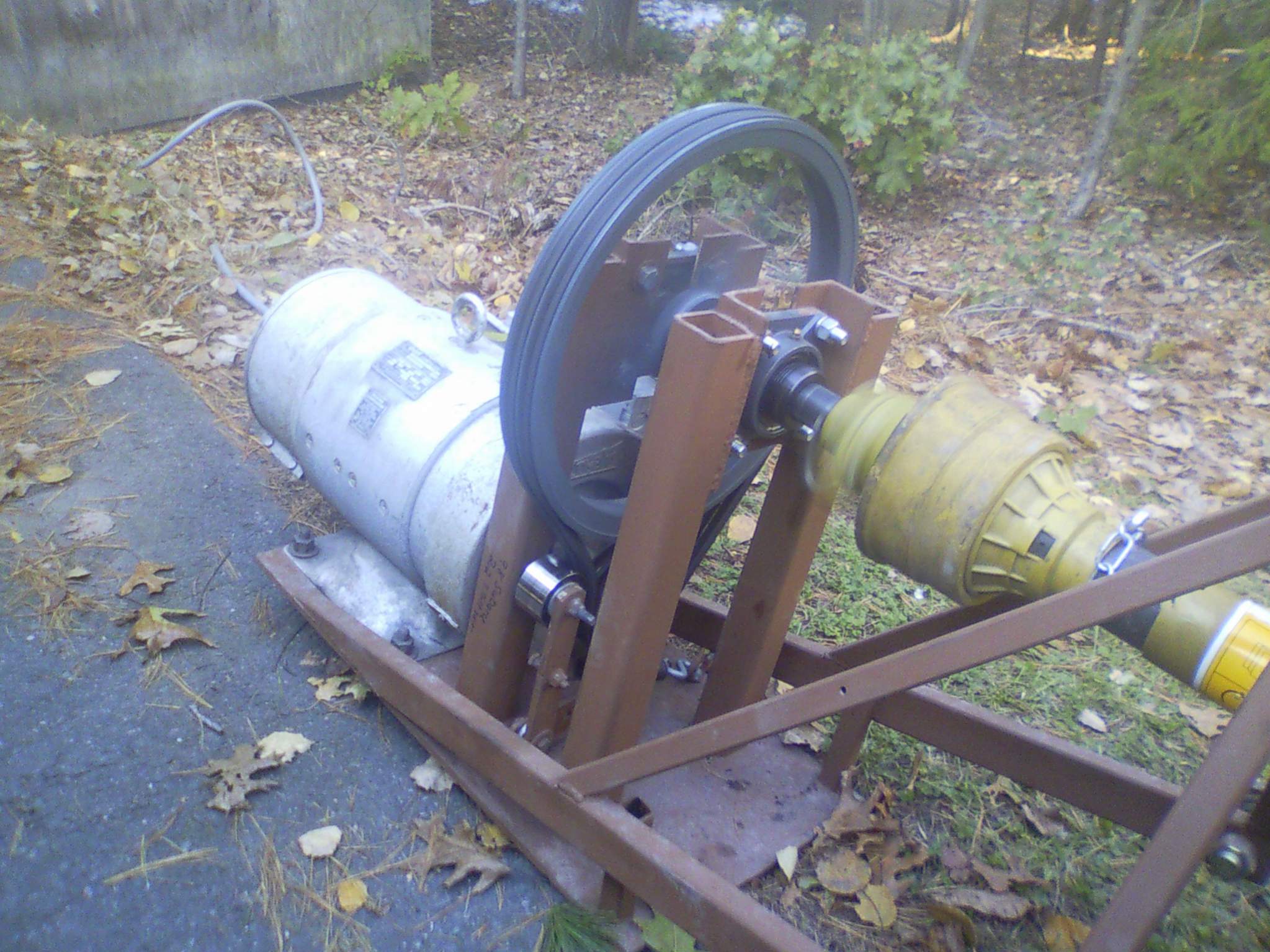

This is the belt driven PTO generator I put together. It is a 7kw military Onan. Yes it has open rotating pulleys as did much of the farm equipment I grew up around. It is being powered by a B7100 and ran 16 hours a day for 7 days. No belt slippage for the output we needed but we only ran it for heat, a few lights and misc electronics. The voltage was watched closely and once the rpm was set for 125 volts it was very steady. The parts minus the generator were about $200. Wide open throttle will run it at 540. With the PTO in high range the engine is running about 1/2 throttle.
There are some people that try to impress other folk with how smart, capable, fit and great warriors they are. By having all manner of hazards about them and be alive to tell the tale.
I see a lazy cheapskate that is in denial.
Set the speed to Frequency, not voltage. It's an AC machine, not DC.

Say what you will but it works like a charm and does exactly what I need. You can throw money around to have all the shinny new stuff you want. When we were with out power for a week. There was no gasoline to be bought only siphoned out of the vehicles. Oh no that's not safe either. I have plenty of home heating oil, and a small tractor that did what I needed. No extra engine to maintain. Why would you really need 14k in an emergency which is what this was built for? Denial hahaha what a trip.
