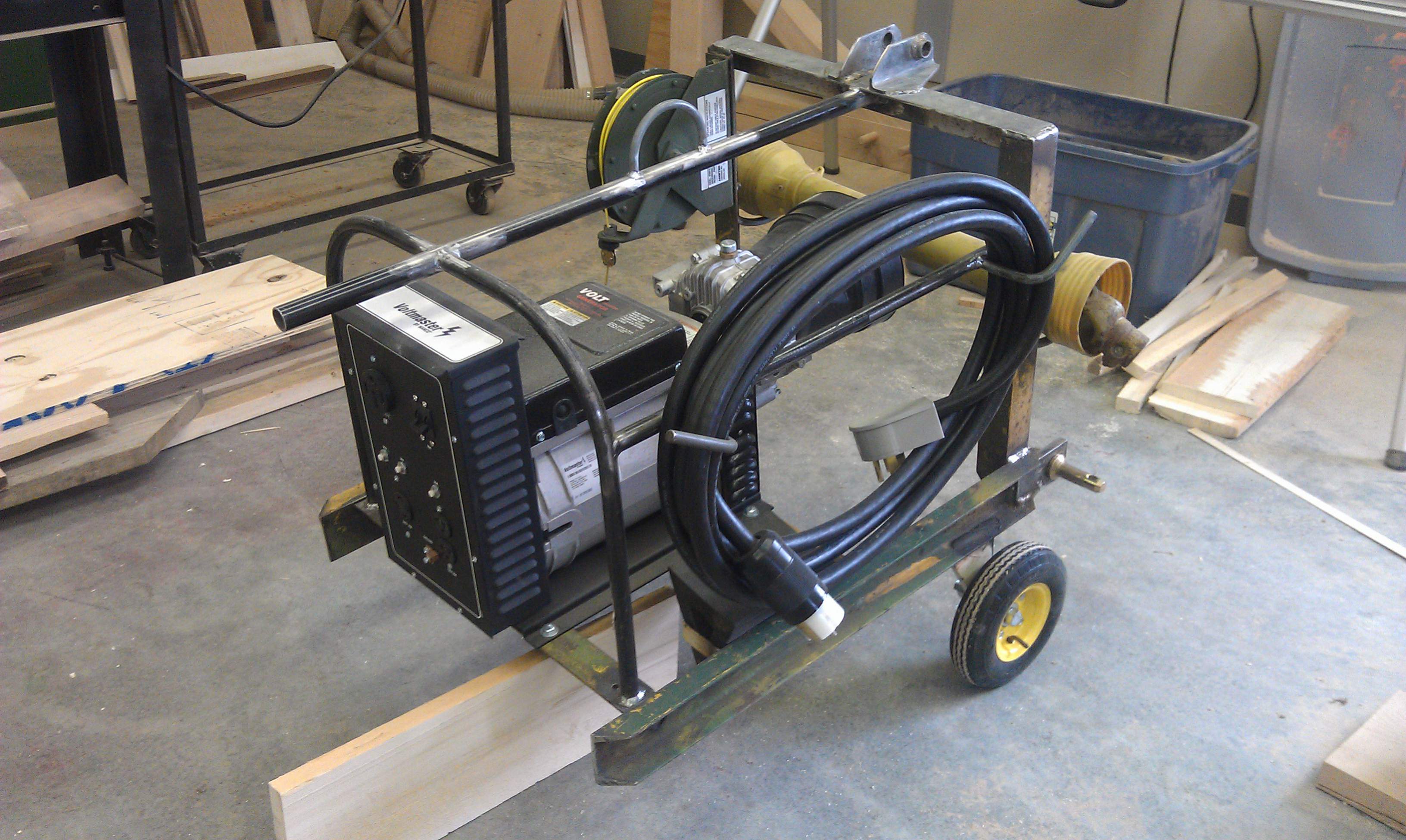

You'd be surprised what a good heavy flywheel on your generator input will do to help out lower hp tractors. Helps smooth out the load when high inrush current devices like compressors, etc.. first start up. Just takes a while longer to coast to a stop when you shut off the pto.

I bought mine out of Penn (drove to dealer in Louisiana to get it) and it is a 1st class unit (course I paid first class dollars during power outage) on a trailer with large wheels; the best thing is my generator only turns about 1800rpm; my neighbor bought a 3pt hitch unit (much cheaper than mine) and it ran at 3600rpm which results in a loud high pitch 'scream'. I would definitely recommend the 1800rpm generator.
/ DIY PTO Generator #47
I thought about doing this but when I priced everything out (10Kw Gen Head and 540>1800 rpm PTO gear box and frame with 3 pt hitch and base) it was cheaper to buy regular generator and safer to operate also. Not burning up hours on my tractor was a point. Not tying up my tractor for power generation was another reason. Pros and cons will vary of course because it is all in what you NEED or WANT. If you can get parts at an auction, flea market or ebay cheap, handy enough to do the fabrication work yourself and only need power for short periods on occasion then I would opt for this configuration. Otherwise I could not rationalize the expense, wear and tear on tractor versus stand alone unit with a wheel kit that I could move easily to a work site. Just my HO.

My point is, if you have a 50 HP tractor running a 10K generator, operating at 1800 RPM, it is not going to bog down the tractor. If you have a 15 K generator on a 20 HP tractor, you are going to want to design it to run at max speed.
I can run a 50kw Winpower alternator with a 22 hp 3 cyl diesel lawnmower by running the mower's pto shaft to an add-on speed reducer. Does not bog down, runs at 2/3rds throttle, all conveniences of the home in use. No noise, no trouble, no problems.

I have a friend that had a nice name brand gas generator. He used it a few times a year and kept it maintained. I had an old pto generator that was made from belt drive unit someone else had built. He kept bragging about the small self contained unit till a tornado took out the power. His machine wouldnt start but his 2cylinder Yanmar would. We got him set up with it. It actually burned less fuel than the gas unit normally did. I dont like to maintain many small engines at the house.
The poster that mentioned the flywheel set up has something. The man that I got mine from he had an old square baler that was worn out. He took the gear box off and mount a large pulley to run the head to speed and left the flywheel on the input shaft. It smooths out most of the loads it gets.

I was intending to build a PTO generator; I have most everything in my scrap pile, a set of gears from an old tranny, a 10kw 3-phase alternator, and I have the skill set for the work.
I just realized that aside from the glory of the thing, it won't be very useful. I'm not going to let my tractor sit outside running for days [or even hours], and in fact our local power grid has been improved and hasn't failed for a while anyway.
It would be more a mobile power unit sort of thing, but I don't have any 3-phase machines that leave the house + workshop.
I guess if I had a smaller tractor it might be more practical.
I made a couple of generators before, one of them on the 40HP 50 year old Mercedes propulsion engine of a boat works really well, the other one on a 22hp 3 cly Mitsubishi diesel couldn't keep the speed steady enough when loaded with more than a couple of kw.
