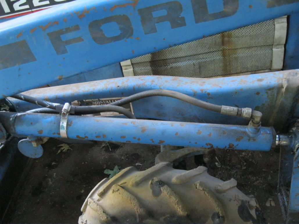

Some pics. By the by, thanks guys for all the encouragement. Now i just have to figure out when I'll have a free couple days to work on them. I use the tractor everyday in the summer and fall. None of the other FEL cylinders leak, only one does. Should I do all four of them?
Based on the photo of the steering cylinder I would suggest first degreasing and cleaning it out completely so you can find out where exactly it is leaking from?
By the way, it looks like the tierod above it is bent pretty good!

I agree that you need to clean it up and make sure the cylinder is indeed the culprit.
IF it is.....it looks like a thread in gland cap but it looks like one that takes a pin-type spanner wrench. (similar to the little tool for 4-1/2" angle grinders) just a bit bigger. IF you are handy....you can make one.
It looks like the pin boss in the end of the rod is a welded on piece. This means total disassembly. Gotta take the piston off the rod to slide the gland cap off that way. Like I said, pay attention to location and orientation of the seals and backup rings.
When putting back together, use loctite or even a chisel to stake the threads on the piston nut. You DONT want that coming unthreaded.
AS to the loader cylinder, pretty much the exact same deal only it has a hex on the threaded gland cap. And I'd only rebuild what is leaking. I use the "dont fix it if it aint broke" mentality on cylinders
