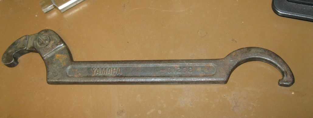

LD1 We are thinking the same! Was just going to ask if i could start the gland caps off while attached to the tractor. Tried before asking, and with a bit of force the loader's Gland Cap moved. Actually, I'm wondering if I can just drop the Ford 7106 loader cylinder's right side down - see pic above - and pull out the piston and rod inners to work with on the bench. Just bought a huge adjustable wrench this morning. The pipe wrench may have worked, but I needed a bigger wrench for other stuff anyway... $20. Gonna try to start the Steering Cylinder Gland next. This, I know I'm going to have to remove the whole unit, for bench work. :) Edit.... Just tried the tool i thought would work on the Steering Cylinder. Gott'er to back out a little on that Gland Nut also in place. Its a motorcycle tool.

Good to read that your project is going well! Sounds like your cylinders were built to be more user-maintainable than my experience.
