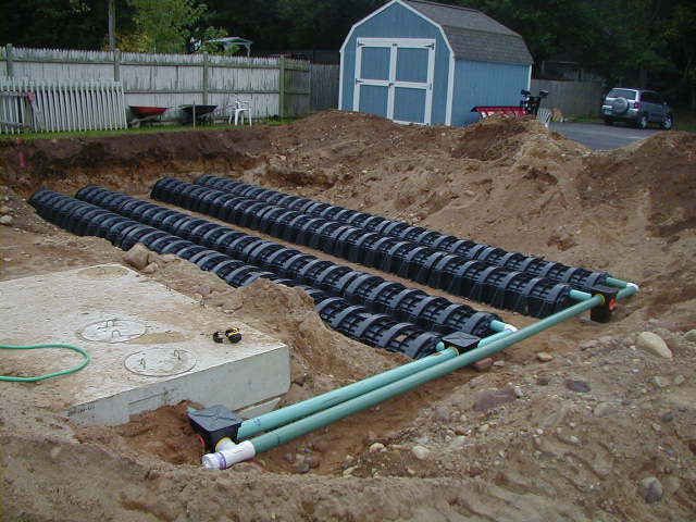

Tommu56, those black boxed with the orange plugs in them are "distribution" boxes or are commonly referred to as "D" boxes. The design requirements to meet the state specifications required me to have two separate trenches each with an effective 330 sq. ft. of leaching. This is a gravity system so the distribution had to be done in such a way that it would be equally divided. The local sanitarian requested that I do the way shown in the pictures. I would have preferred to feed down to the first set of infiltrators and then from there to the second set. He felt that in order to conform with the code I had to do a distribution before it reached either set if infiltrators. I don't know that it makes a hill of beans difference but of course in order to have the system approved I did it his way. I balanced them by using a garden hose and watching the flow down each circuit and adjusting the heights of the "D" boxes. Once I was satisfied I placed a patio block under each one for it to rest on. The reason I have the leach field configuration I have is due to space limitation. In a larger area I could have had the two single leach fields going in different directions and did the distribution between them. Hope this answers your question.
P.S. There is no valve in the "D" box it is simply a square vessel with a round opening on each side.
