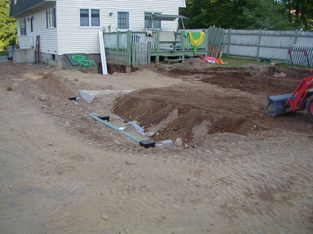

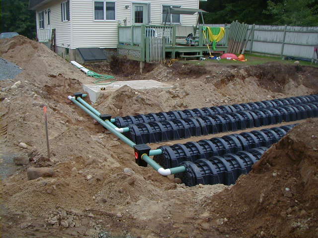

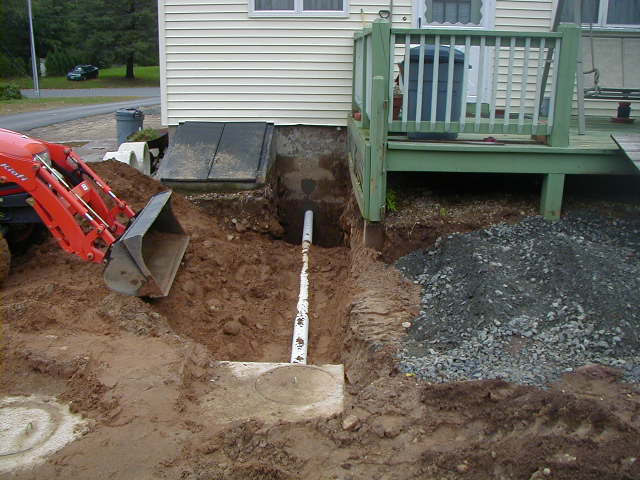

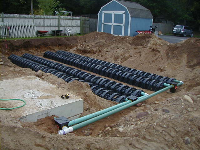

Looks good! I was down your way today at the fire station for a memorial service. Glad to see you'll be able to make the fair.
/ DIY Septic System #63

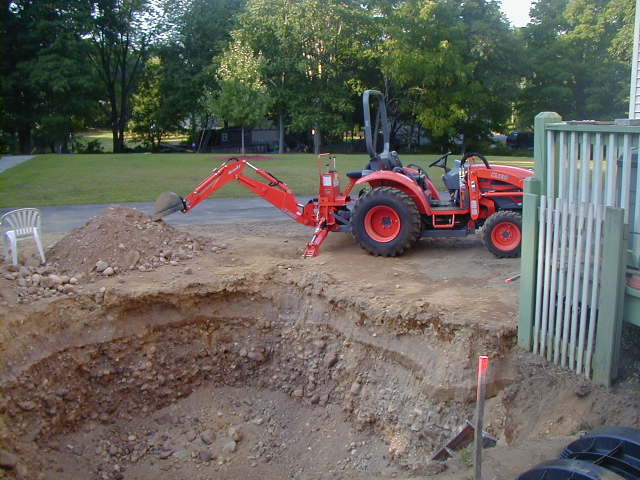

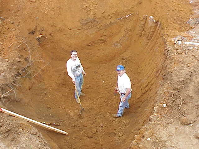

Big job. Great job. Lots of set time. Congrats! It looks very well done.
Peter
/ DIY Septic System #64

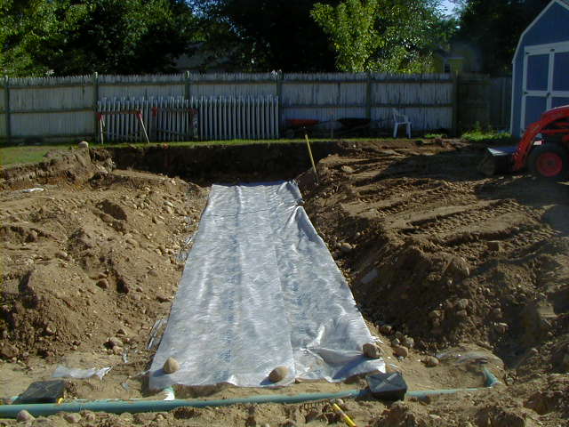

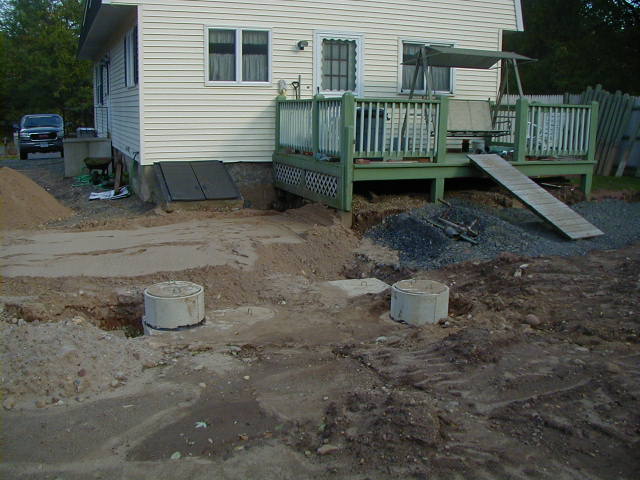

nice job but I can't figure out why they let you get away with running on the leach field around here they do not want you on it. we dig them with the excavator or backhoe for a underground one and must stay off them then till the stone is in for a sand mound (raised bed) they don't want any equipment at on it till after you have so much of the sand on it so you don't pack the ground down and affect the drainage
/ DIY Septic System #65
The law here is likewise, surface must be scarified before stone is installed, no wheel, truck or excavator tracks visible. No one checks it though, so everyone backs the wheelers on to dump the stone.:eek:
