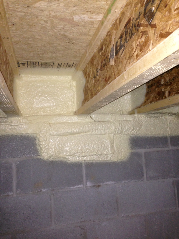

Most of my house is blow in insulation because it was cheaper than foam. We did between the joist with foam. It really wasn't a DYI job. I would recommend paying someone to do it. If you are determined to do it yourself you should buy the right equipment, and sell it when you are done. Why do you need your pole barn to be air tight? . image-4087776495.jpg

Why do you need your pole barn to be air tight? . View attachment 435502
I was wondering the exact same thing. Why such and emphasis on airtight? what is the building going to be used for?
Given the really high cost, for a barn, I like fiberglass and blow in. The insulation in the walls and the ceiling are the least of my concerns as far as thermal efficiency. Rather the sill seam, around the garage doors, walk thru doors, windows, etc.
I just put up 2000sf of insulation in my walls. R-19. ANd plan on blowing in R38 in the 1600sf ceiling. Few contractors I talked to were rough estimating 8k+ for spray of comparable R value. I will have $1400 in fiberglass and blow in.
