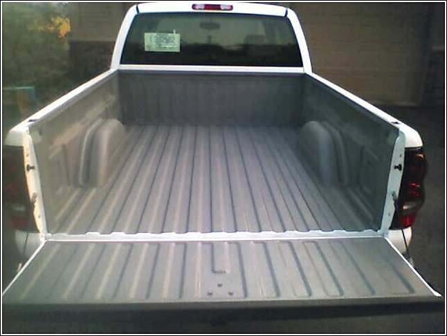

Here is a photo of the bed completed after the masking was removed.

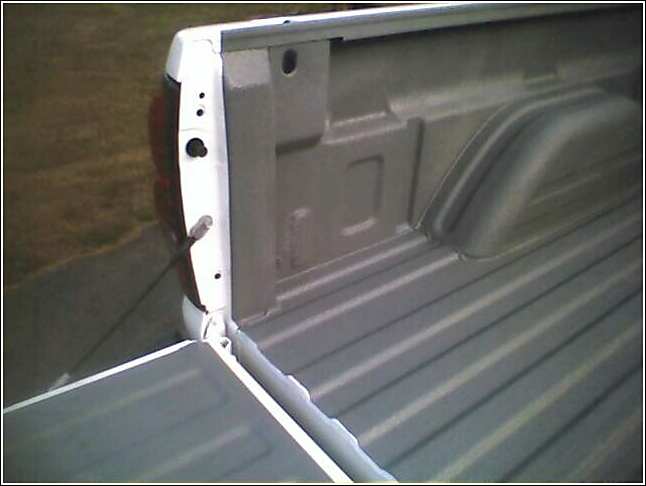

#16
This is a detail shot of corner and the tailgate. You will notice that the spray on liner does not fully cover the top rail of the truck. Most services that spray these on completely cover the top rail to protect the paint from scratches. This truck will be getting a full graphics decal wrap that will completely cover the paint job, the decals won't stick to the rough surface of the spray in bed liner material so the bedliner was just sprayed over the inside corner of the bed rail, this will allow the graphic wrap to be applied over the exterior corner of the bed rail, it will make the graphic look better than if we had to cut it short due to the bed liner.
