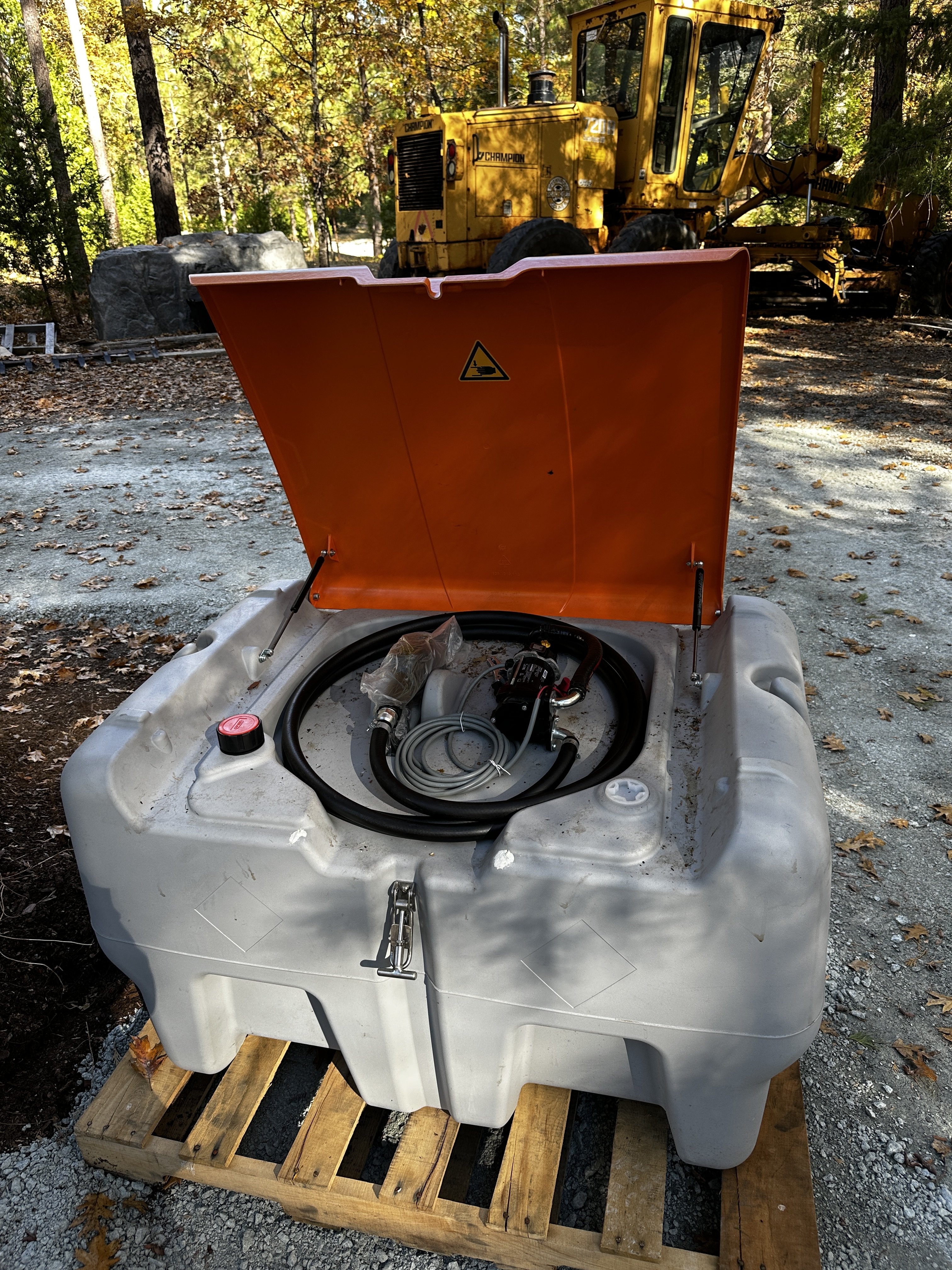

I use this plastic tank. But it’s only for Diesel which all my tractors are. It has fork slots, so easy in and out. I holds 116 gallons.
