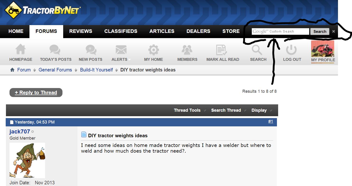

Use the "Google Custom Search" at the top of the page, not the "SEARCH" icon below it. Use as few words as possible.

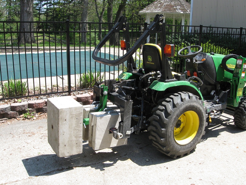

Lots of ways to go. I have a trailer hitch receiver on a quick hitch drawbar I built, so I just poured a big block of concrete around a 2x2 tube. I also cast up some concrete "suitcase" weights to sit on the drawbar.

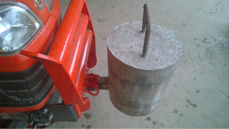

I did something similar for the front of my small tractor. image-3586604311.jpg This keeps my front end on the ground when using my carry-all.
Receiver draw-bar in a 5-gallon bucket. Piece of cake...
I plan to make some extra ones that will hang off of the side.
