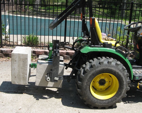

The cheapest weight is concrete (although a bit bulkier than steel). Here are my weights. The suitcase type weights are on a drawbar and the block is on a hitch receiver.

the concrete is soooo cheap and easy to form that even though less dense, it's still not bad if you have the room.
cast iron is king.. but the prices are terrible.
