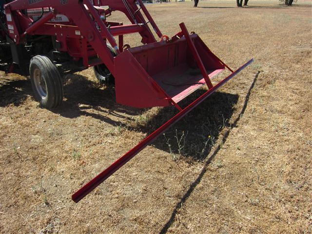

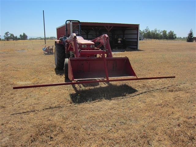

Agrisupply has 5-ft wiper modules for about $100
String Wing, 5' Wick Appicator, Chemical Applicator | Agri Supply, 71934, Rope W
I have three of them that attach to the FEL on my Mahindra 5525
Use it to apply glysophate (generic Roundup) to my 6 acre hayfield to control fiddleneck weed.
I order 2.5 gal containers of concentrate from Home Depot at $49 each. Order two of them since HD has free delivery for orders over $75.
Good luck.

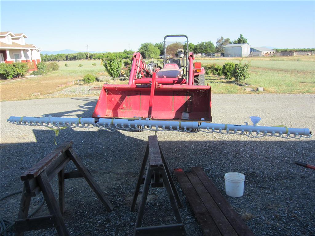

I built a 10' wide wiper from parts supplied by Rodgers Sales Co., INC
It works well but slow. If you go too fast the weeds don't get a good dose. Mounted on the lip of the FEL. Couple of design changes I made was using test plugs to seal the ends and clamps to allow the wiper to be rotated while mounted. The test plugs are easy to open and rotating the wiper allows emptying the pipe into a bucket when finished.
   / DIY weed wiper #8
I too built a wiper with Rodgers Sales Co parts. The kit has the hard to find items and you supply the pipe and glue. The finished weed wiper works great.
I can be slow. The manufacturer of my wick applicator recommends two passes in opposite directions to be sure the weeds get wiped. With 15-ft wide applicator, I can treat my 6 acre hayfield in about 3.5 hours.
