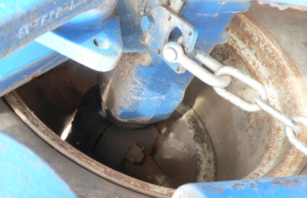

What I would try first is loosen the hub clamps and slide the wheel out 2 inches. They look long enough and strong enough to work that way.
That looks like a bad idea to me. The hub clamps are out at the end of the axle against what looks like snap rings. 2" more would be an unfair load and might come off or break. Look at the hub picture in post 13.
Looks like he'll have to swap sides or make spacers.

This is the picture of the hub that looks like it would be long enough to remove the snap ring and slide it out a little. Hard to tell from this angle, would need to measure the length of the hub.

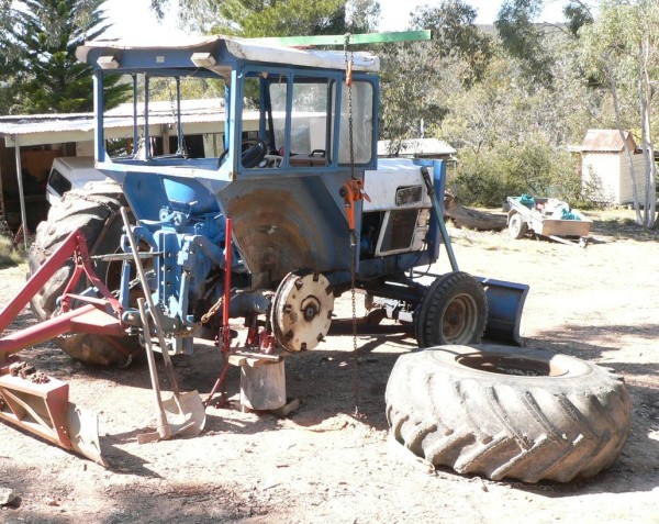

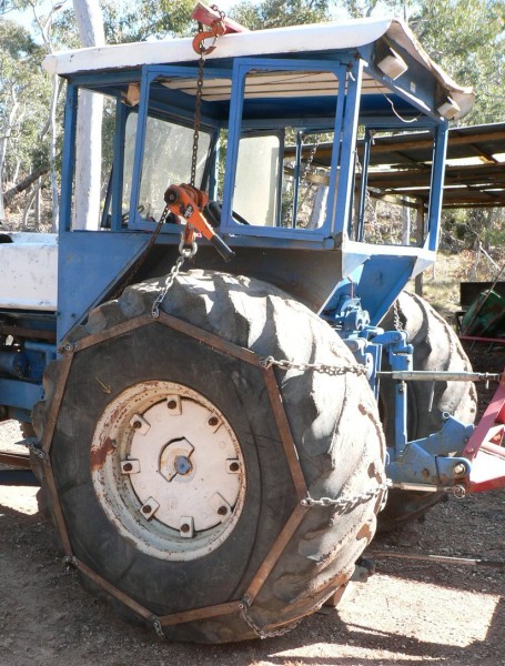

The tractor has been lifted on a jack (also with supports under the frame) so the wheel just clears the ground. If necessary, I can dig a hollow under the wheel rather than try to raise it any further
You can see in the picture the lifting frame and lever chain hoist attached to the wheel. I used this arrangement once before and it worked fine. Fortunately, I'll have some help this weekend to turn the wheel once it is clear of the hub. The hoist will then lift the wheel to the right height to re-seat it.
Wish me luck!

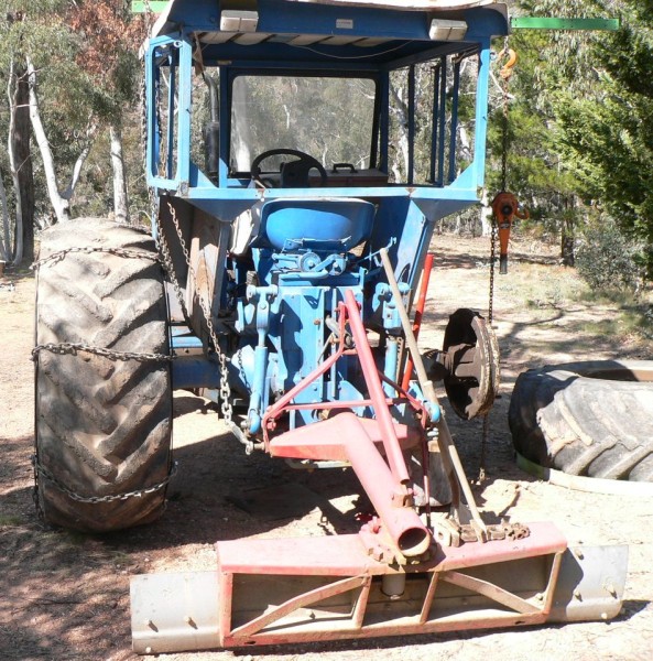

One wheel has been reversed. Not a particularly easy job but the result is excellent with a space of over 9" between the frame and the tire. When I add more cross-chains, that should fix the traction issue on that wheel
The other side is a different story! The jig that worked perfectly on the first wheel struggled to lift the rim clear of the hub and I now know the reason - this one has been filled with water. Finally got it off and it is lying on the ground.
My next challenge is to work out how to turn the massive weight of this sucker so the valve is downhill and the water can be drained. Then the wheel will have to be moved to the compressor or vice versa. Then I'll have to get it upright, spun around and re mounted on the hub - unless I can borrow a second tractor to work with my jib that ain't gonna be easy.
