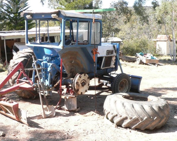

I managed to lift the tire with a farm jack high enough off the ground on one side to get a strap under it, so if a neighbour will loan me his tractor for a few hours. I can fit my jib to his 3 pt linkage and lift the wheel into a vertical position.
It also occurs to me that once the wheel is upright, the strap can be re-positioned around it and the whole thing lifted, turned and moved back into alignment with the hub without draining the tire. That would save a sh*tload of work. My jib is very strong and the tractor I have in mind is nearly as big and as heavy as mine. Worth a try,

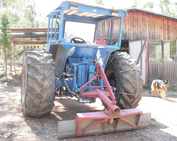

All fixed - what a swine of a job (no adverse comment on pigs)
As noted earlier, the second wheel turned out to be full of water and I was kidding myself expecting 300 Kg - it was double that and actually BENT the jib just lifting the wheel (not the tractor). Fortunately a neighbour had another heavier jib so with many changes of sling positions, much backing and sheer grunt, three of us finally managed to lift, swing and relocate the wheel onto the hub. One of the biggest hassles was getting the locking tab on the wheel lined up with the matching slot on the hub.
The chains are now on - both lateral and around the circumference - I might add more if needed
Incidentally, this job followed on from replacing much of the exhaust, changing the fuel line and bleeding the system, replacing the main hydraulic line to the front cylinder. Oh also replacing the timber roof supports with steel and scraping out 6" more earth to provide greater height in the tractor shed
