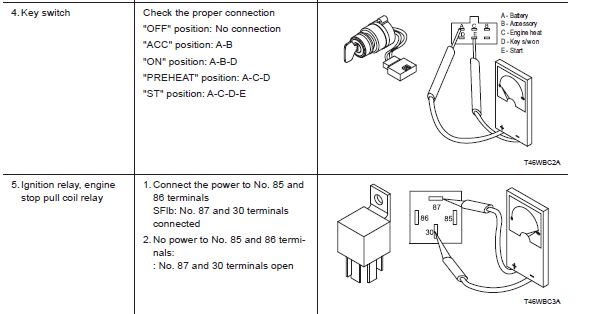

I think I'm going to pick up a few of those solenoids, it's probably just a matter of time before one fails. They are small enough to carry in my toolbox so I would always have them. Someone mentioned that it's a generic part that can be bought at an auto parts store. Does anyone have the parts number handy? My service manual is with the tractor at another location. I tried michigan iron, but couldn't figure out how to register to search there website (only allowed you to sign In, but not register). I can keep searching some old threads here too.
   / DK 40 HST will not start ?? #19
I don't have any part numbers for you, but this diagram of the start relay and the fuel shut off relay (they are the same type of relay) may help. The coil is between the 85 and 86 terminals and the contacts are the 87 and 30 terminals. Probably best to take in one of the relays with you to the auto parts store. and find one of the same rating and terminal layout.
