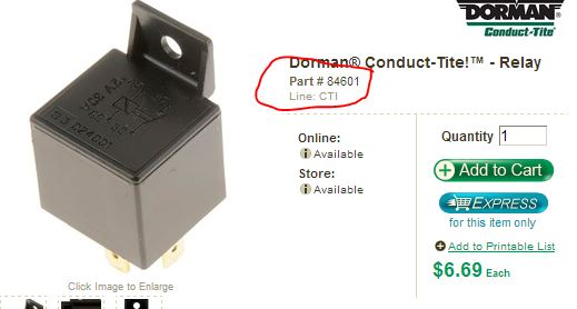

Koua, speaking of looking parts up, when I opened your link to the solenoid. It didn't show any part or number. Do you still have the part number?
   / DK 40 HST will not start ?? #27
Here you go. Orielly part number 84601 line ct1.. whatever that means.. perhaps part of their stocking scheme.

Thanks James K. Both relays are on my spare parts to purchase list and I will get these ASAP.
   / DK 40 HST will not start ?? #30
Before you purchase, look at your original, and make sure that the pinouts are the same. I just looked them up, I did not cross reference with real world. I believe they are correct, but I did not look at the originals. They are 30 amp relays I know that much.
