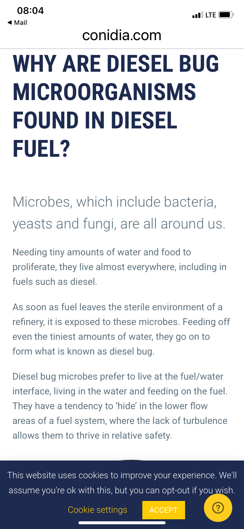

I don’t think it’s quite that simple, but I do believe it’s a fuel delivery issue. I think that the fuel tank should be drained/flushed and the lines blown out with compressed air.
Is there any evidence of diesel bug? Any good treatment used will kill the bacteria, but the dead bugs will turn to goop and plug lines/filters unless the complete fuel system is purged…

You may have microbes growing in your fuel. Change out the fuel filter again and report the result.
