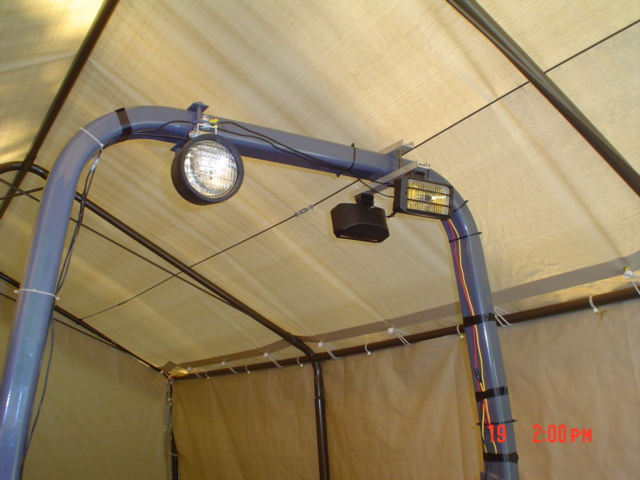

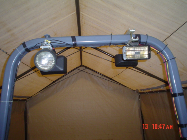

I keep a couple of chains to each side of the seat on old towels. As I'm never that far from the house I have not worried about adding a larger tool box. In the tool box I keep stuff for changing from backhoe to 3pt hitch, small flashlight, small multi tool, crescent wrench, and couple of screw drivers. That fills it up. If I ever get a flat then I would call in a mobile tire repair truck. Did add extra lights to the ROP's, two facing forwards and two facing backwards.

I put the lights on after the first winter. Cleaned about 3/4 mile of road several times with the FEL . Problem is when lifting a bucket full of snow the headlights are blocked by the bucket. If you ever backup at night or have to use the backhoe at night then those lights become very useful. Hopefully you don't have to go out at night and clean your driveway or road. :D

Yes you can put the ROP's down with the lights on it. Just leave a little slack at the pivot point. There a several threads on putting lights on and finding the correct electrical connection point. Just have a look for them.

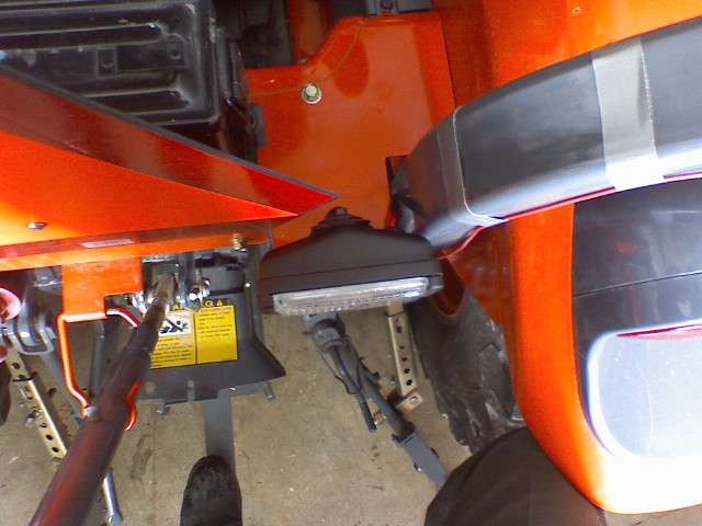

Yup, one of the first tasks I took on after purchase. The stocker is good for little more than a glove holder. I used an old .50 ammo can. I drilled two holes in the bottom aligned with the OEM box's holes, cut a piece of old fuel line (3/8" ?) and slit the entire length to fit the bottom lip on the ammo can (for abrasion/vibration dampening), then bolted it into place. Fits perfectly between the seat and SMV sign, only slightly larger foot print than the OEM. I've attached the only file photo I could find right now (box is in upper left of pic), can take a better one if you wish.
