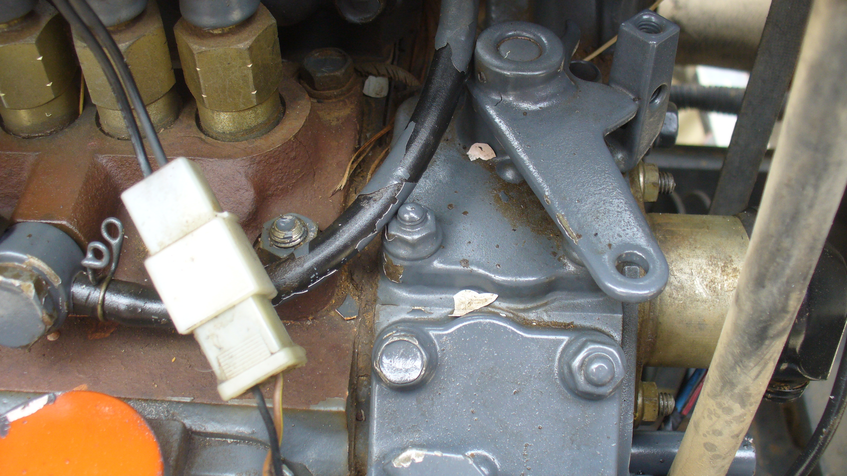

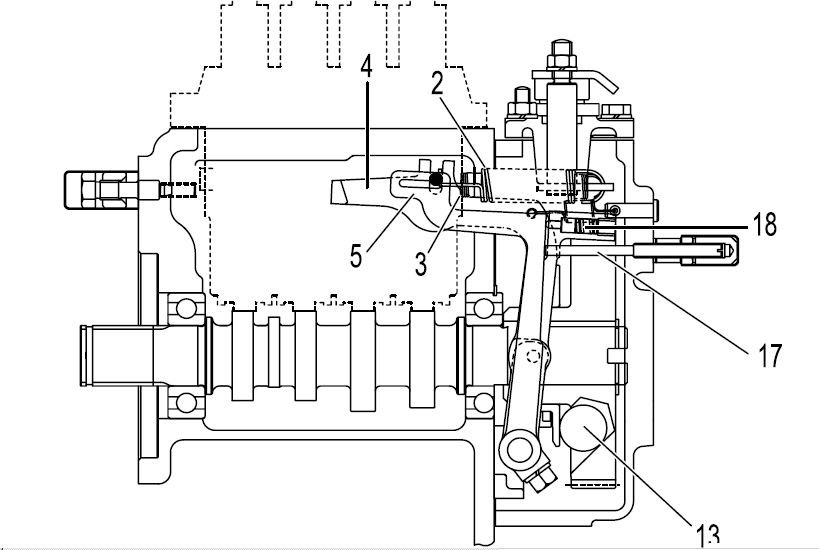

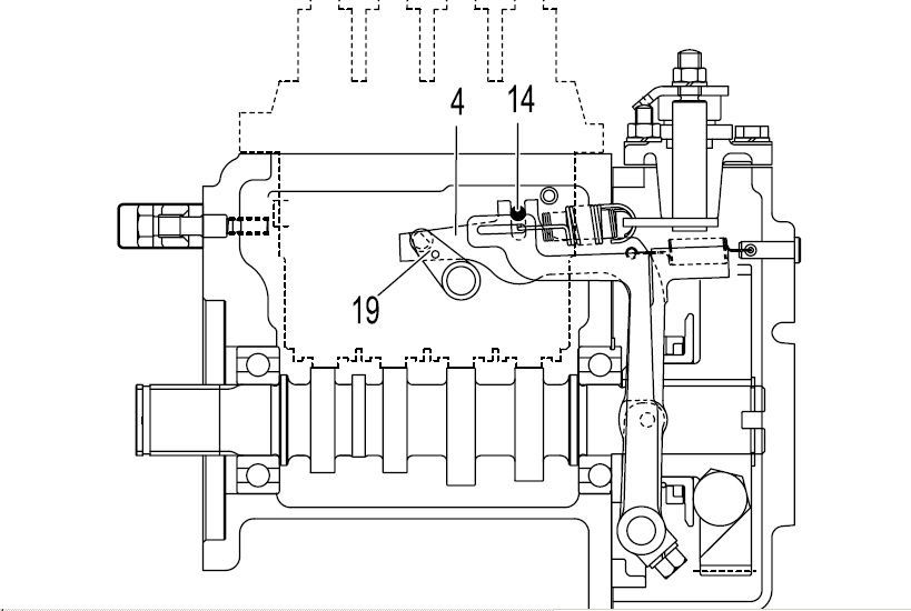

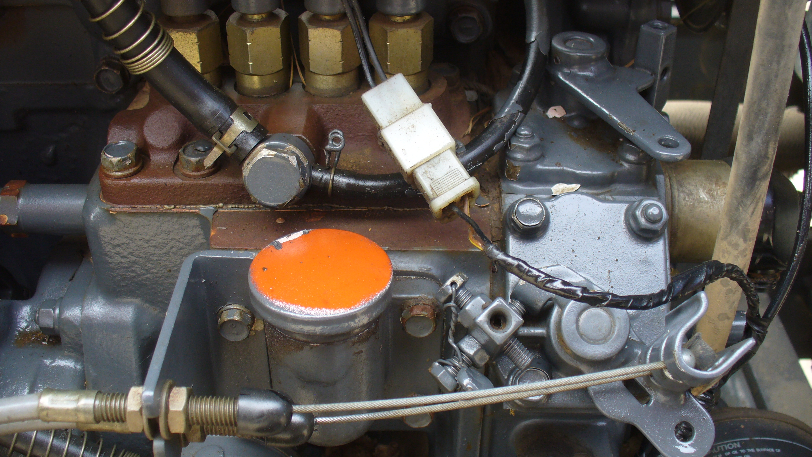

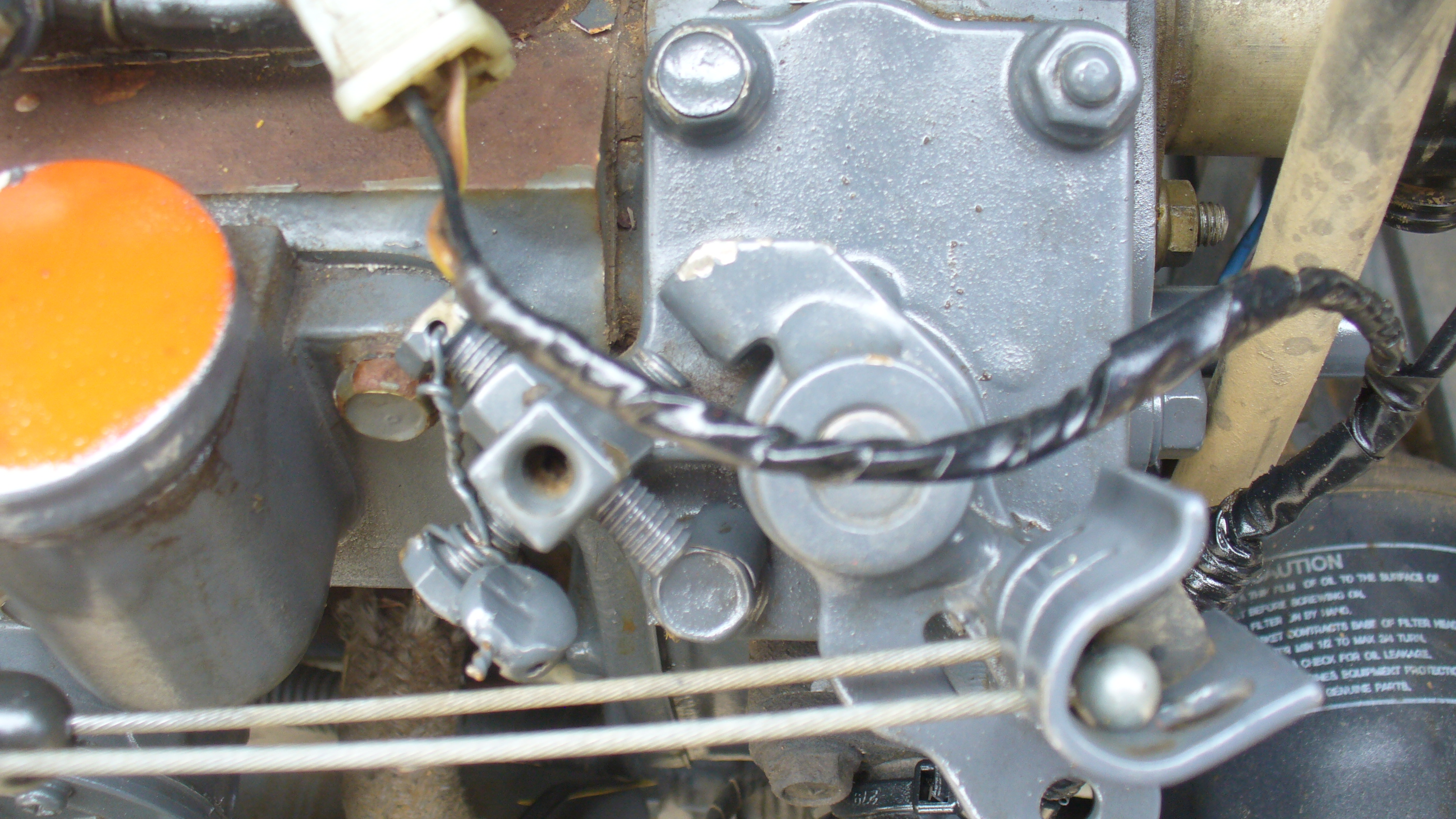

Comparing actual photos of the engine (taken today) with the drawings in the Manual, I just cannot reconcile them, and leaves me wondering if the drawings relate to the same engine.
Photo 2 shows two levers, but neither looks identical to Lever 19 in the drawing.
When I stopped the engine last, the fuel was low but not lower than usual before refilling. I did top up the fuel, sofar no go.
>>> Is part of your fuel tank above the level of the injection pump?
I'll need to take another look for that.
Photo 2: Shows both Levers.

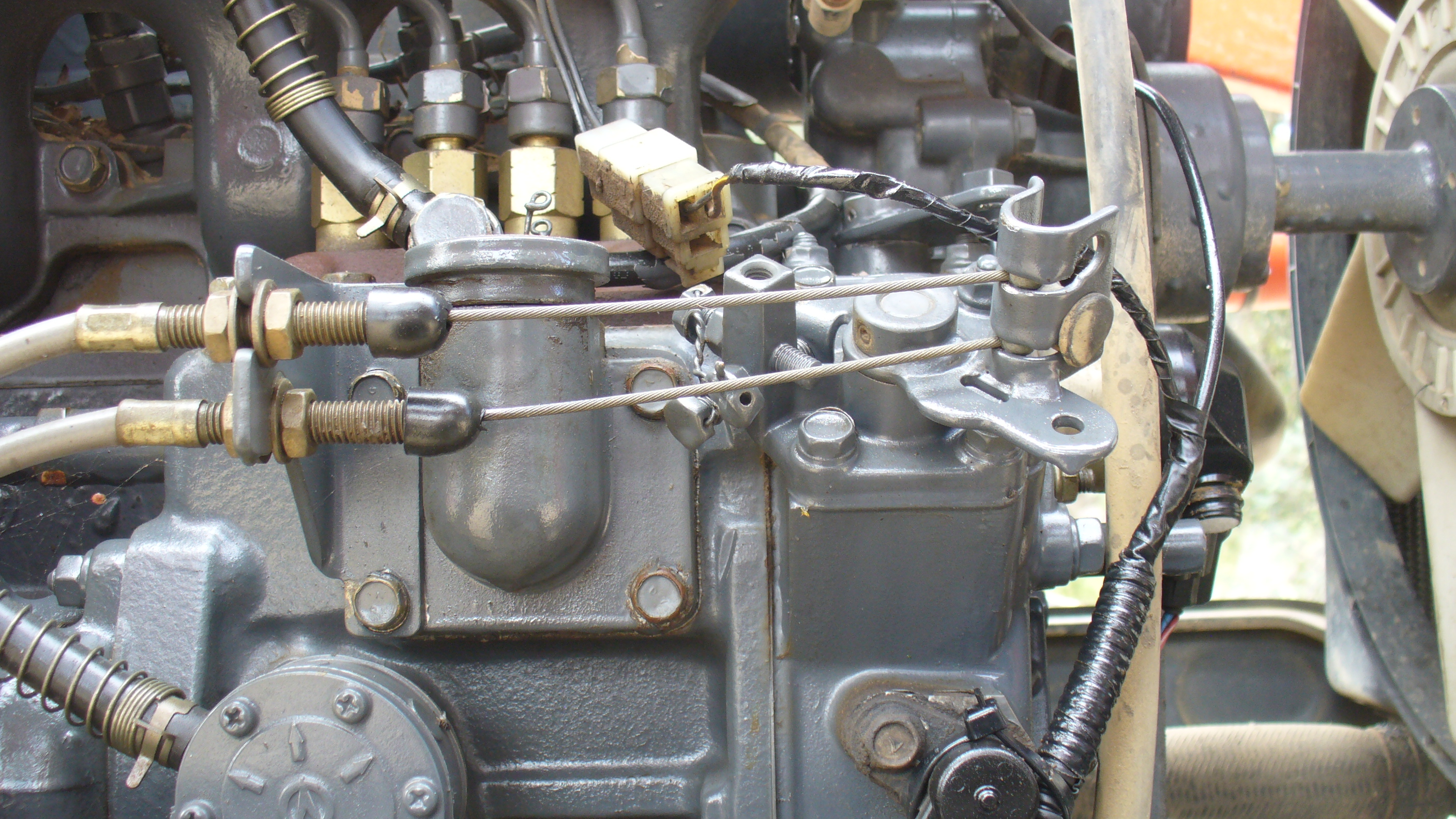

Photo 3: Shows that it does not always rests on the minimim idle position. Should there be an external spring?
Photo 4: I have no idea what that lever is for. There is no external spring attached but is does return to the position shown.
Will do the flow testing tomorrow.

I thought there was a solenoid-operated fuel valve that shut off the flow when the ignition key was off and allowed fuel flow when it was on. If not, then what causes the engine to stop when the ignition key is turned off?

There is a 10A fuse labeled "alternator/engine stop".
It is located fifth slot down on the fuse block located right side below the steering column.
Right is pre 2007 left after May 2007
View attachment fuel solenoid.pdf
In your pics you can see the fuel shut off solenoid is pre 2007.

It is wrong to assume that the name Engine Stop solenoid is doing what it says.
I learned my mistaken understanding recently on a Kubota whose injection pump looked a lot like yours.
After I made the statement which turned out to be wrong, I studied the wiring diagram and to my surprise the solenoid actually enabled the engine to start when powered up.
Regardless of what it is doing, all these solenoids have two winding's inside. A pull in winding and a hold winding. The pull in is only powered briefly to move the hardware and then the hold coil takes over.
It is most unfortunate that Kioti does not make available parts diagrams and more. Every search I make says go back to your dealer. Kubota on the other hand has a wealth of on line info readily available.
The two wires going to your engine solenoid should have power present in one circuit when the key switch is on and on the second one also when cranking. The ground path is through the injection pump body.

I think the engine stop solenoid stops fuel flow when it's not energized. On my Branson it's energized when the key is in the on position. Doing it this way is safer- if the solenoid or the circuit to it fails the tractor stops running (or won't start). If it was energized to shut off the fuel flow a failure would mean you could not turn the engine off. The Branson manual says that it's difficult to hear the solenoid move. This is a Bosch pump which is different from yours but it may be hard to hear yours move too.
The lever on the fuel injection pump that's not connected to anything is probably the mechanical engine stop lever. The Branson manual warns that if it's in the wrong position the engine won't make full power. If you happened to mess with it, it could be part of the problem. I don't think it can get into the stop position on its own. This seems like an electrical problem but I thought I'd mention it.
The Branson (Bosch) stop solenoid has 7.4 ohms resistance and draws 2 amps when the key is on.

Today I visited my poor tractor and made the following observations regarding the solenoid (freed up the wires and disconnected plug, voltages are between ground and Red/Blue wires):
Key SwitchRed wireBlue wire
Off0V0V
Acc0V0V
On12.5V0V
Start12.5V0V
No voltage was observed on the blue wire in any position. Cannot find any further information on that solenoid and wiring diagram. Clearly the diagram I have is misleading.
Next I took off the top cover to locate the relay which is in my Owner's Manual referred to as 'THE POWER OF TIMER RELAY', which may or may not be the same as 'Alternator/Engine Stop'. This manual contains no further reference to such relay itself, and the ink on the relay labels is unreadable.
