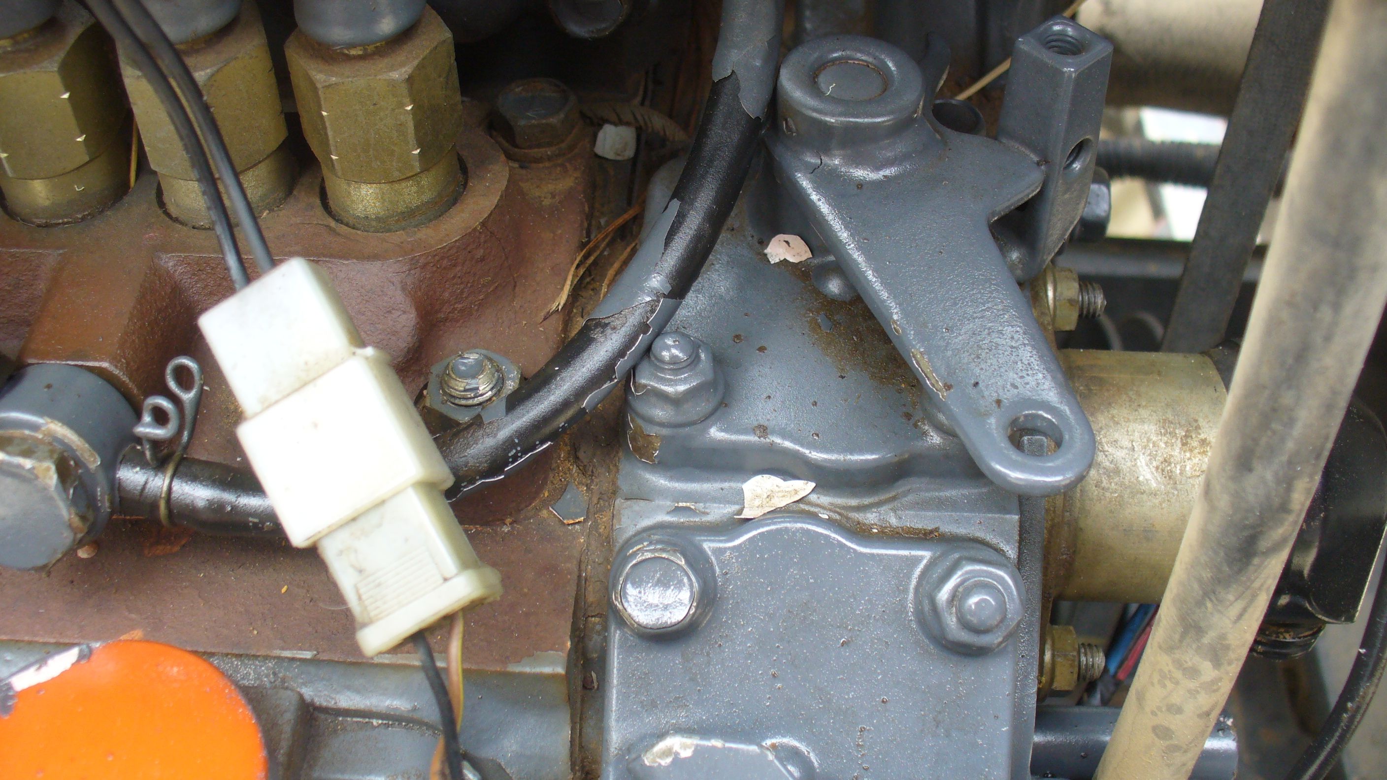

About the solenoid, there is a few ohms resistance between ground and the pin on the socket to which the red wire connects. Means there is something inside but nothing on the pin connecting to the blue wire. Nothing measured between the two pins either.
Have been trying to figure out where the other end of those two wires go... no luck yet. Difficult working conditions in the blazing hot sun.
Circuit diagram is next to useless.
Q1: Anyone know what that lever is for in the attached photo?
Q2: That solenoid is attached with two bolts, anyone has any experience removing it and see what's inside?

On the Bosch pump that lever would be the manual shutdown lever. It's in the same location on your pump, next to the cutoff solenoid. The Bosch manual says that it may not be connected to a linkage, and it's not on my 3725.
   / DK40 cranking but not starting
#29
In the position shown, would that be fuel off, or fuel on position? Does the position change when you start your engine? (I never took notice of it).
