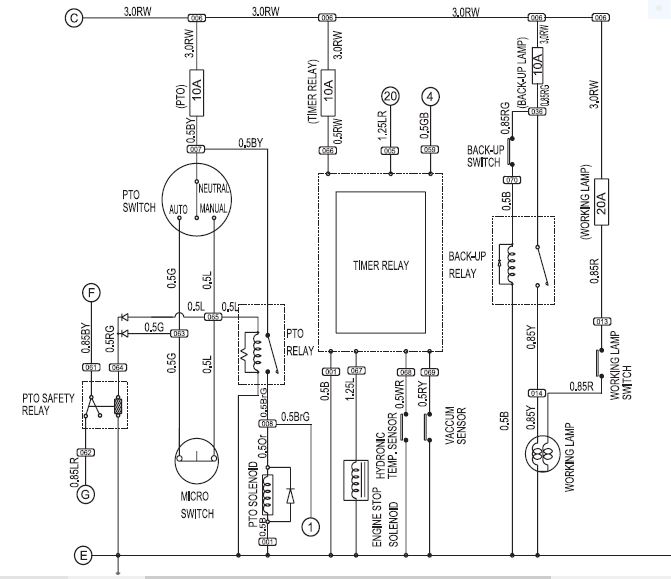

I think this shows the correct schematic for your tractor. The DK40 schematic should be the same as the 45.
Scroll all the way to the end for the schematic. The stop circuit is is in the bottom left of the drawing. You will see the timer relay has seven electrical connections; I believe this is a short pigtail wire bundle with a connector at the end (NOT like a typical plug-in relay cube).
This image (zoom in) from the MIE online parts manual shows the timer relay (#8). I can't tell exactly where it is but it's not on the "firewall" with the glow relays. It may be on the side of the cowl or maybe behind the instrument panel.

I don't know if this will help any, but here is a snip of the old style DK showing the electrical for the timer relay and stop solenoid.

Based on the schematic and your comments Relay timer #8 @ $ 47.83 is the correct part for my DK40, to control my stop solenoid.
Please confirm I'm on the right track and I'll order the part?

Mike inspect the tractor and if you see a module that looks like the one that rich pointed to in his link then you can be sure that is the correct part you need to order. My SE tractor is much different and does not have this module.

For future reference,etc., the full 18 page linked electrical schematic, #5, Main Circuit, shows the Timer Relay, part#8 with 7 wires connected. I just uncovered that relay which lies directly under the fuel gauge (right side) on the cowl side of the firewall. Access is via the plastic dash and other plastics surrounding and below the dash. The parts list shows that relay as T4340-60243 but (weirdly-the North Korean weird? influence) my part has a clear sticker with T4340-60242 on it? Maybe a superseded#?

Can anyone advise what is the nature of the VACCUM SENSOR (Vacuum) on the schematic shown in post 10. Where would Vacuum be sensed on a turbo charged engine?
It appears that any solid jumper wire would defeat it. Similarly the "Hydronic temp sensor". But that safety shut down feature is part of the Hurlimann wiring harness.

Mike: As far as I can see, the timer relay is the only thing that can be frying your stop solenoid or preventing it from stopping the tractor (knowing that you verified the solenoid functions correctly on 12v). That solenoid was intended to be powered for a only few seconds. So I am confident you need to replace the timer relay.
