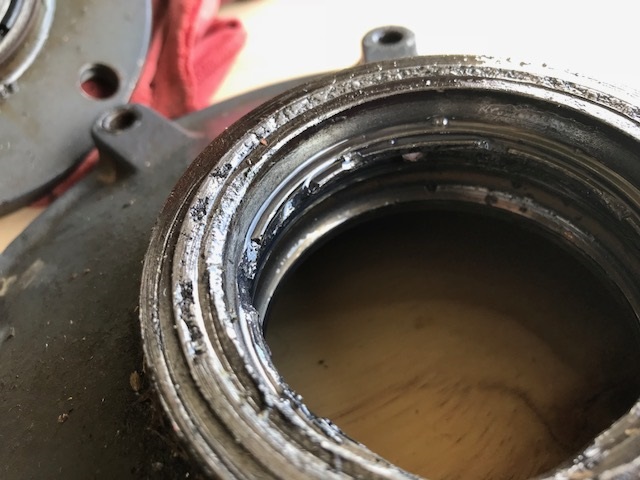

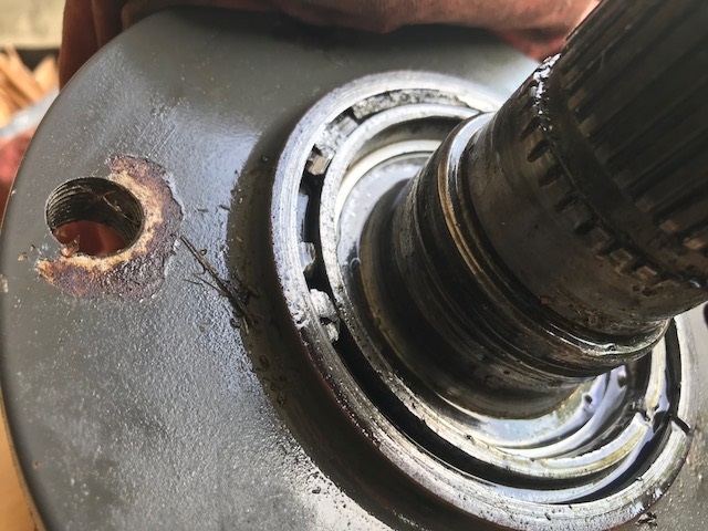

1300 hours? Lucky you. My DK45 happened at 660 hours. Of course the onus is on me for misdiagnosing as the O-ring on the 8 bolt cover and not a bearing issue. I heard very little and thought resistance was due to brush hogging. Fortunately I was slowing down when the wheel came off. I see very little damage to the internal gear but it is doubtful I can reuse the cover or the wheel spindle gear again. outer.jpg
