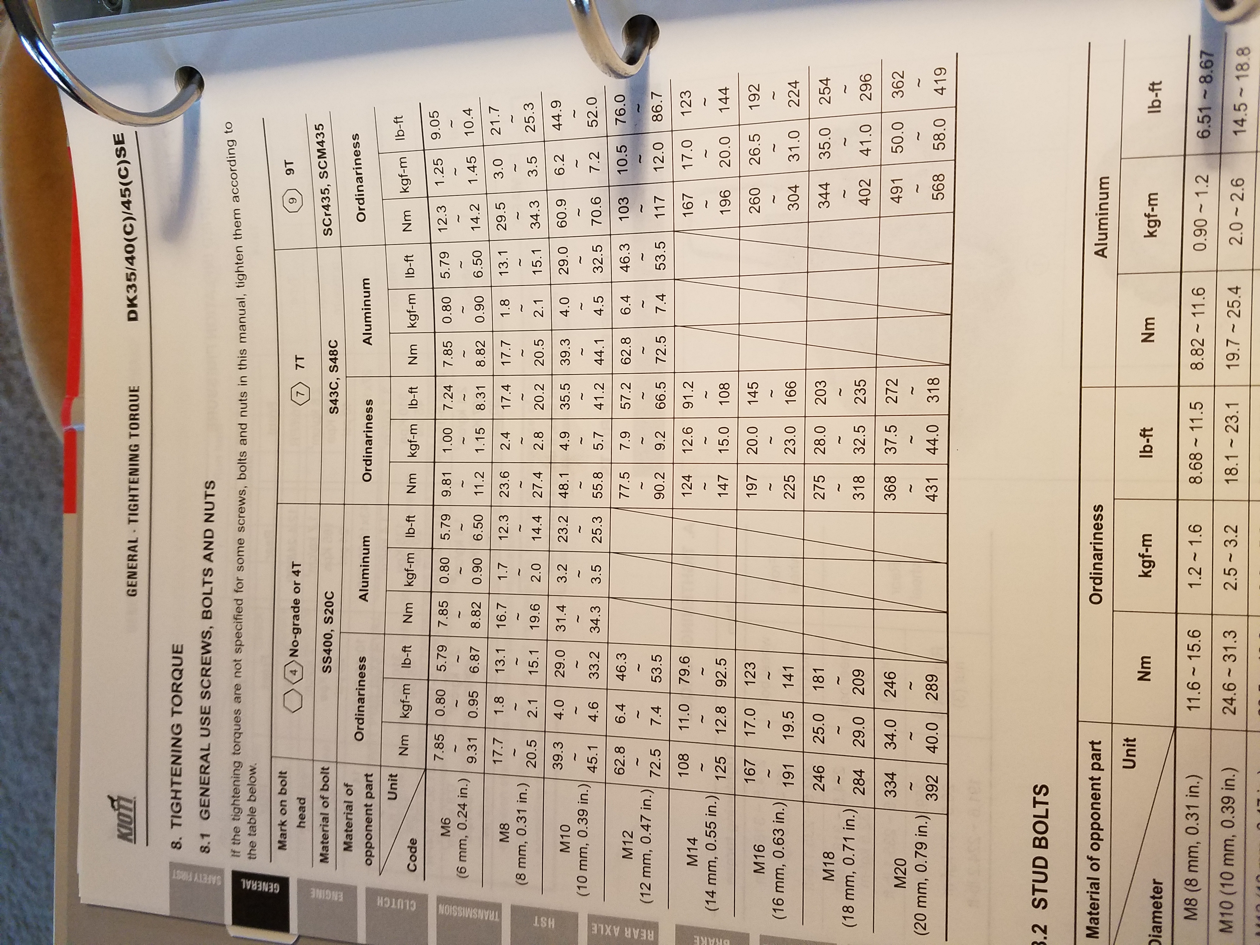

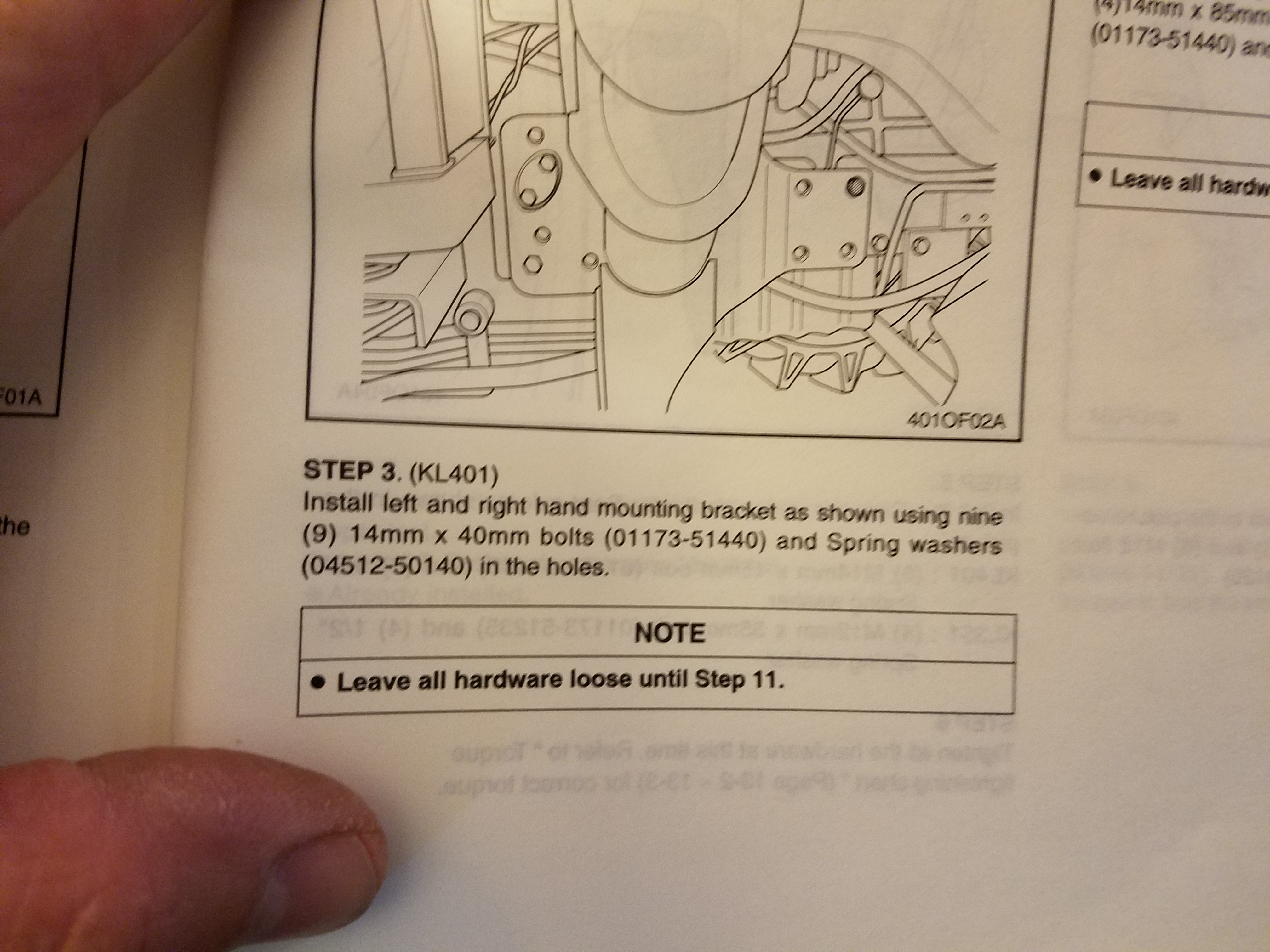

Holy crap, I have the answers right here! Just need to open a few books and quit being lazy.
Service manual has a great torque chart for the bolts in question Loader bolts.jpg. My loader owner's manual has the exact sizes of bolt used in each position. Torque chart.jpg
