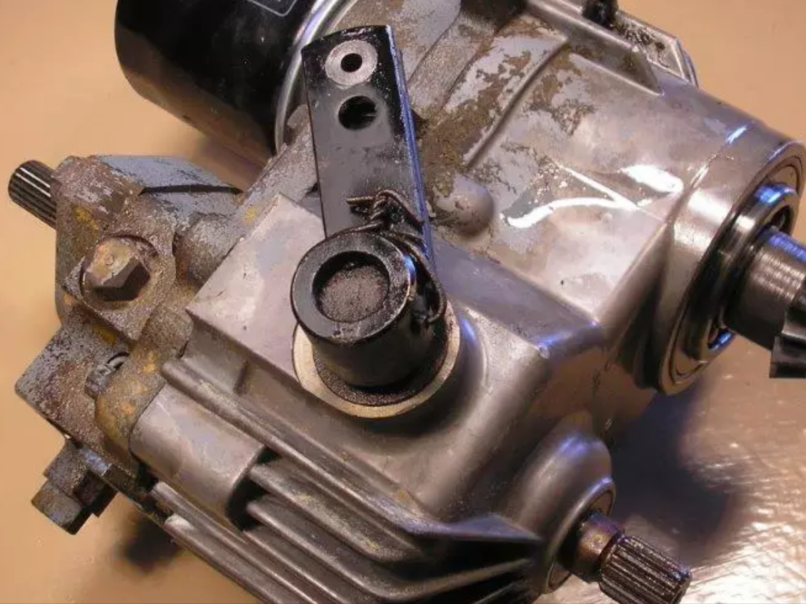

Although this is an old thread, I'll post a solution I just found that fixed the "flakey shifting" problem on my 2011 DK35SE HST.
Over the last couple of months I had an increasingly difficult time shifting from Medium to High range. I tried lubricating everything as noted in this, and other threads. Today I could not shift to High at all. The shift lever would hit the front stop on the tractor frame before it had moved the gear far enough to engage in High.
Taking a closer look I noticed the spring pin that attaches the shift arm to the shaft that goes into the transmission was protruding to the rear. I used a hardwood board and hammer to push the pin back in, and that fixed it. I am fortunate to have found it before the pin completely worked its way out.
A pin was also protruding a bit toward the front of the assembly, and I thought it might be broken. However, it appears to be a spring pin inside another spring pin shown as parts 2 and 5 in this diagram from Michigan Iron:
Parts Finder Michigan Iron & Equipment Morrice, MI (855) 265-459
The inside pin was wobbling around inside the outer pin. It may also explain an intermittent I starting problem where the range selector showed being in Neutral but the starter would not engage. Perhaps it caused the range potentiometer in the control circuitry to send out a flakey Neutral-range signal (there are two values), thus preventing starting.
Anyhow, if range shifting is flakey another possibility might be the spring pins on the shift lever shaft.

Kco, glad you got you problem resolved and shared your observations. If you are afraid the rollpins may work their way loose again you may want to thread a wire through the rollpins and twist around the shaft.
It won’t stop the pins from egging out the hole if they are that loose. It will keep them in place though.

I don't know if the loose pins were causing my intermittent starting problems. However, they seemed to be occurring more frequently as it got harder to shift into High. I guess I'll know if it was related if the intermittent starting problem disappears.
Re: your question about the hours...my tractor is at 1,395 hrs.
   / DK40- wont shift into low or high range? #30
That's an excellent suggestion. I added a wire this afternoon and will keep an closer eye on the roll pins. As K0UA suggests, using two roll pins is a questionable design. I've got my pins back in but they are not completely flush on each side of the collar. If I tap it flush one way the 2-pin assembly slides. So the smaller pin is not completely in the larger pin. I got it fairly close by squeezing the two with channel lock pliers but will align them better when I can get some help. It is an awkward place to work. I can tap the larger pin from the front side with a hammer but need to use a piece of rebar to tap the smaller pin from the rear side. I'll get my neighbour to help so one of us can hold a large hammer against the front side while the other taps the pin from the rear side.
