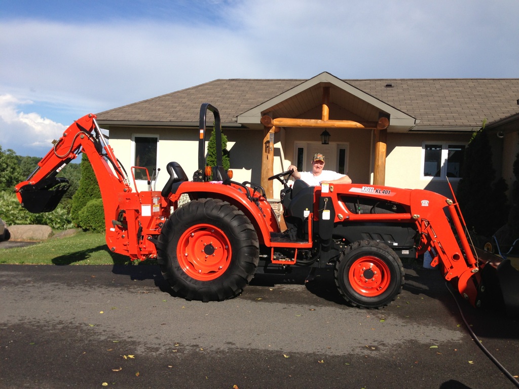

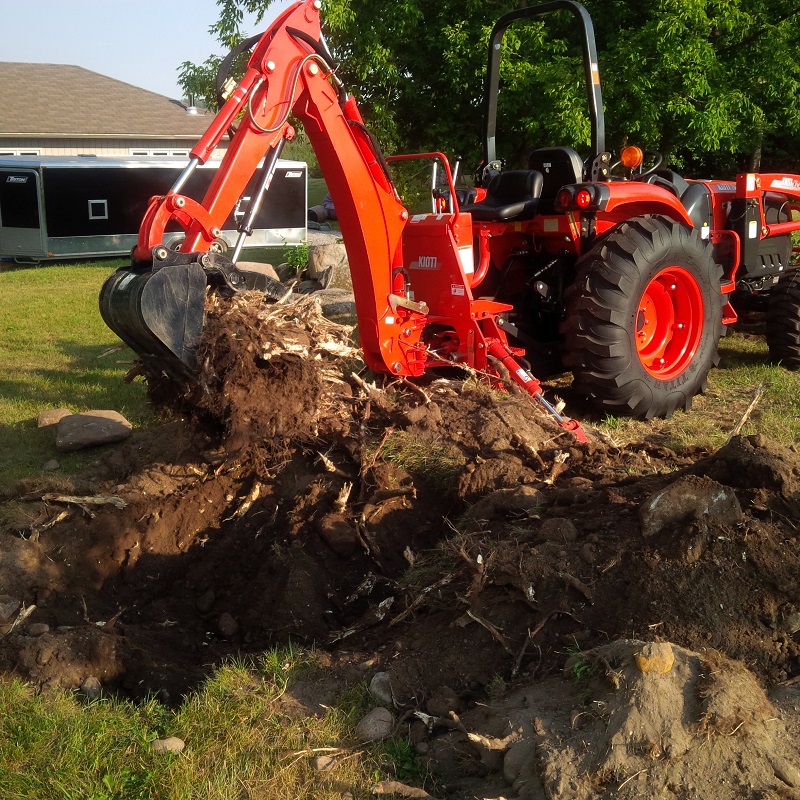

So after a lot of dicking around with my bank and waiting on parts at the dealer, I finally have a working tractor! Spent some time yesterday ripping out some stumps, my first time with a backhoe, not as much power as perhaps I thought but got through some pretty nasty roots.
I have lots to get used to power-wise.....the HST is MUCH different than the old gearbox tractors I used to use, really seems to lack even when I was just driving up some small inclines. I hope it's not an issue come winter when I have to clear my steep driveway, which was the justification for getting the tractor.

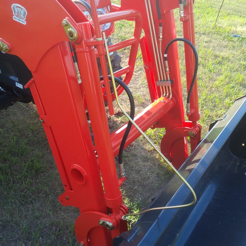

Didn't put in too much work with the loader for clean-up but managed to bend the level indicator....something tells me that this must be common?

That would't be the first level indicator bent up. I managed to bend mine the first 10 hours or so. I straightened it back up and re-installed. My indicator tube came apart is the reason I wadded mine up. I locktighted it and staked the threads. It looks like yours just got caught in something? With HST, when it has trouble going up a hill, back off of the forward pedal, do not press harder. If that won't make it up the hill shift to a lower range. Remember HI range is only for roading the tractor on relatively flat ground not for any work. Most work can be done in MED, and when you really need torque or to slow down the tractors speed response to the pedal, put it in LO.

Yup kOua got it right on the head. You have to learn how to use your speed ranges to accomplish the most out of your machine. Good luck and have fun. As for the leveling rod well mine snapped off the moment the loader was lifted for the first time coming off the delivery truck lol. Someone had forgotten a couple of bolts or something like that.

I saw the thread about the rods as soon as I posted this one. My dealer has already said he'll be out to replace it as soon as they have one in stock, nice to see they are so responsive.

Mine was bent that bad or worse, and I just laid it out and straightened it by hand and with a small hammer. It is perfectly straight now. They seem to be pretty good metal.

Nice rig. Wish mine still looked that new. Be sure to put a wrench to all the loader frame bolts and nuts. Even though they may be tight after initial assembly, they do have a habit of working themselves loose.

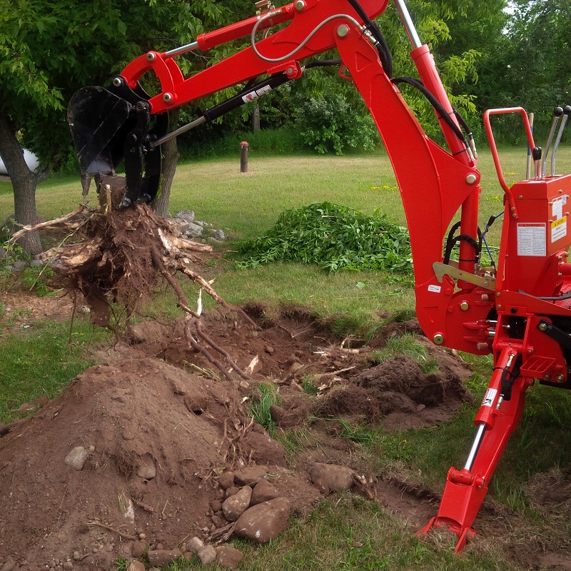

Disregard the quote, hit wrong button. What brand is the thumb and where does the hydraulics come from.

According to the first pic you posted the tube for the indicator rod is on upside down.

It's a Michigan Iron Equipment thumb, my Kioti dealer ran all the hydraulics. It's a pretty slick unit but draws all of the hydro power on the hoe when it's clamping.
