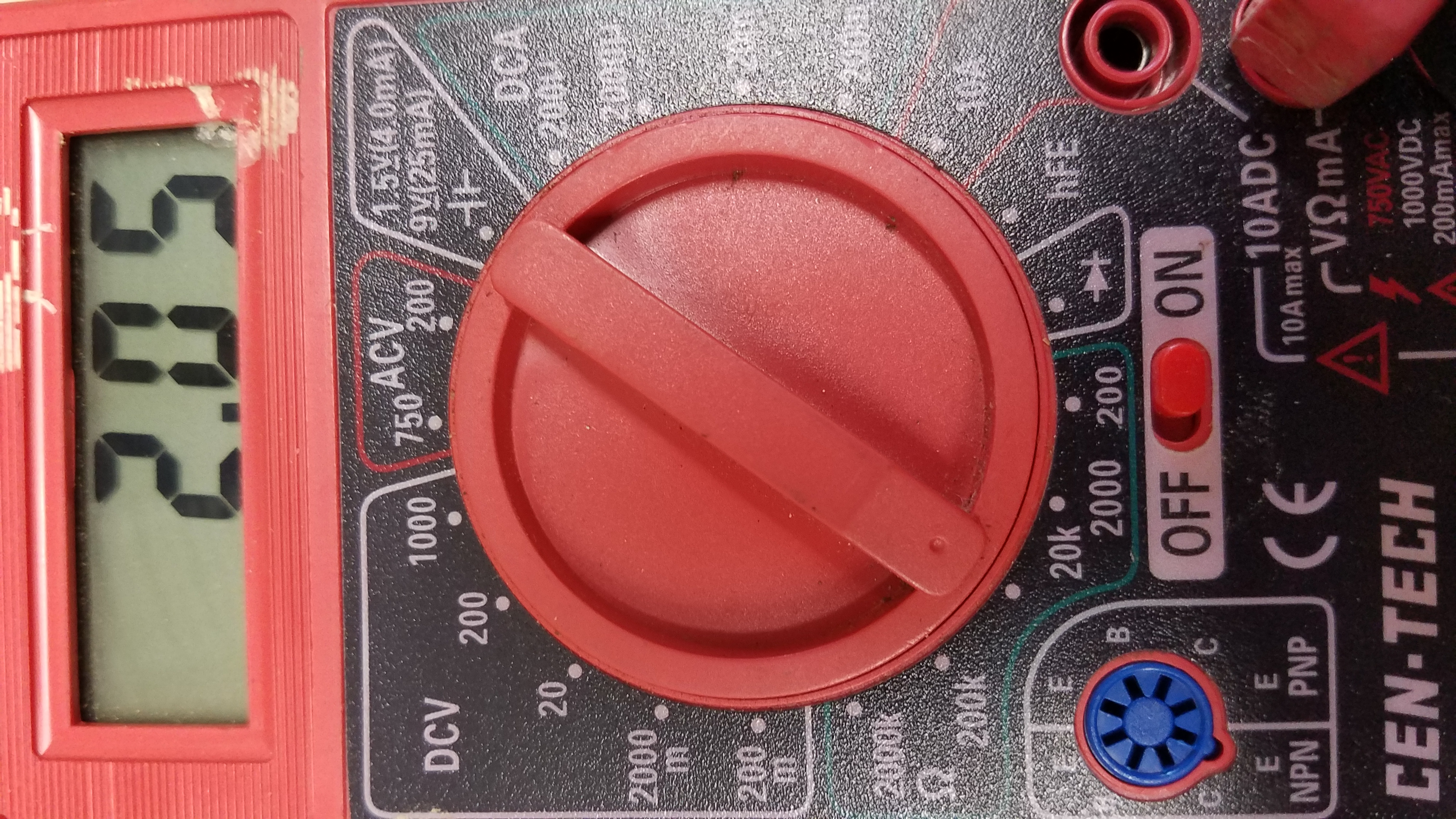

   / DK40SE no start...pulling my hair out now.....
#9
Well, after i removed the potentiometer and double checked it I realized we had the multi-meter set wrong and on the correct setting it tested good.
Back to square one....
