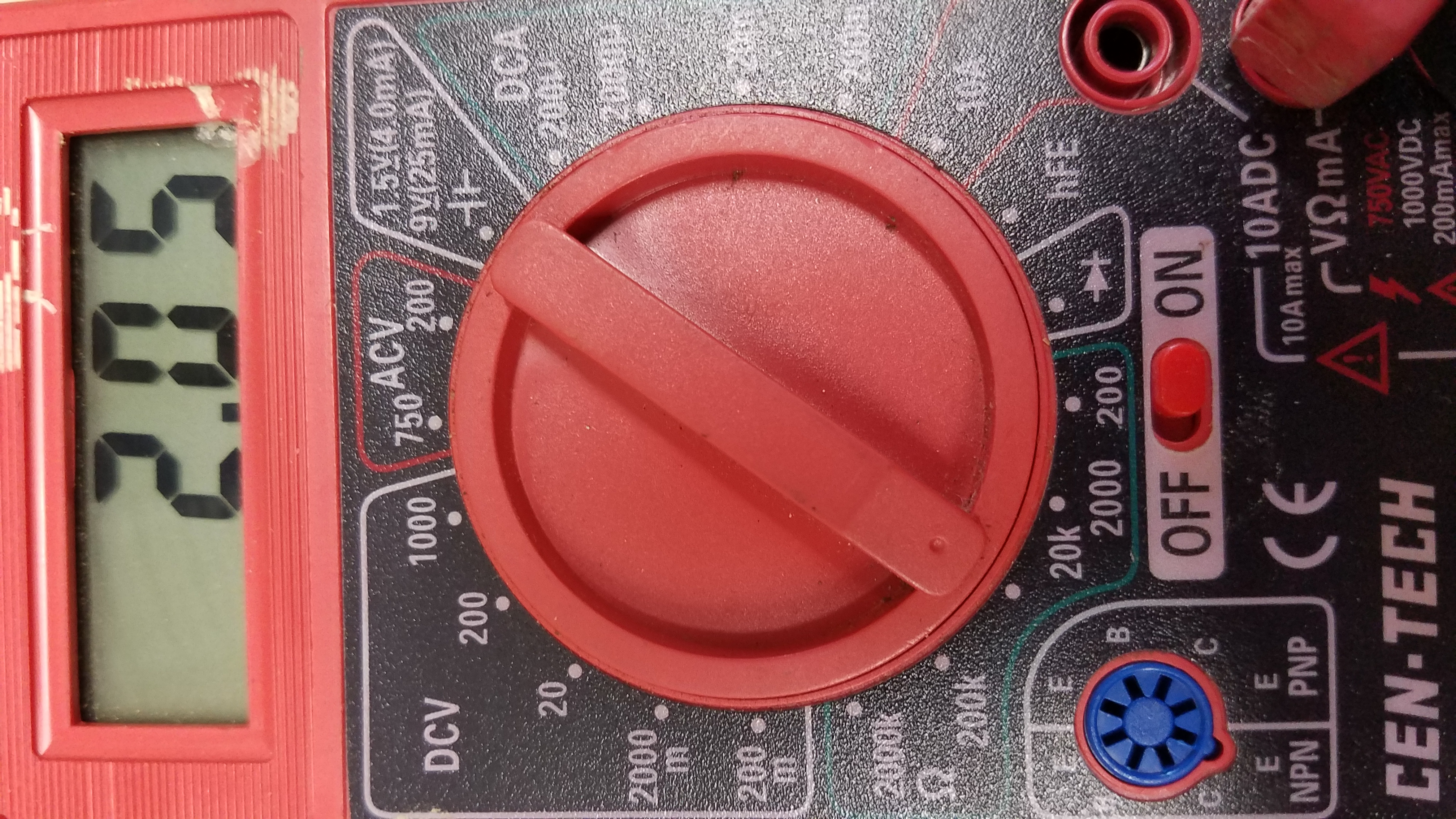

Since your meter is not autoranging, you need to start on the scale with the expected value of the component under test. Start a potentiometer test by testing the two outer legs. This will be the overall resistance. See that it is near the expected result by the schematic or value given in the literature. Then test each leg to the center leg which is the "wiper". See that the value changes as you move toward and further away from the fixed legs. There can be gaps and "dirty" spots in a potentiometer where the wiper does not make good contact with the substrate of the fixed resistance. You may not be able to see these rapid discontinuities with a digital meter very well. This is one reason to ALSO own an analog meter. They are much better for seeing this type of failure. A tech should own both digital and analog meters. And preferably more than one of each.
All that said, I assume you are satisfied that the pot is not the problem, especially as you stated that the Nuetral lamp was lit when the range selector was placed into neutral. The cruise control acts as an integrator that "reads" the variable voltage placed on the high side of the pot and the wiper of the pot than sends that voltage to the cruise control module which "integrates" the voltage level and decides if it is within the specifications and then sends its decision out thru a diode to the start relay low side. The high side of the start relay coil should have +12 volts on it from the ignition switch when in the start position. ( you should measure that) and, IF the ground is "thrown" thru the diode by the module the start relay coil will pick energize and the start relay contacts will send +12 volts to the starter solenoid on the side of the starter. Those contacts will engage and the high current will flow thru those contacts and spin the starter motor.
You can also apply a temporary jumper-ed ground on the start relay low side to prove that every thing from start relay and ignition switch start contact out to the starter solenoid and its contacts all work. This would bypass the decision tree of the module and the nuetral safety pot, and PTO safety switch.
The starter motor should crank, and at least you would know that all is well from the starter relay forward. This is what I would do. Look in your service manual to figure this out.
