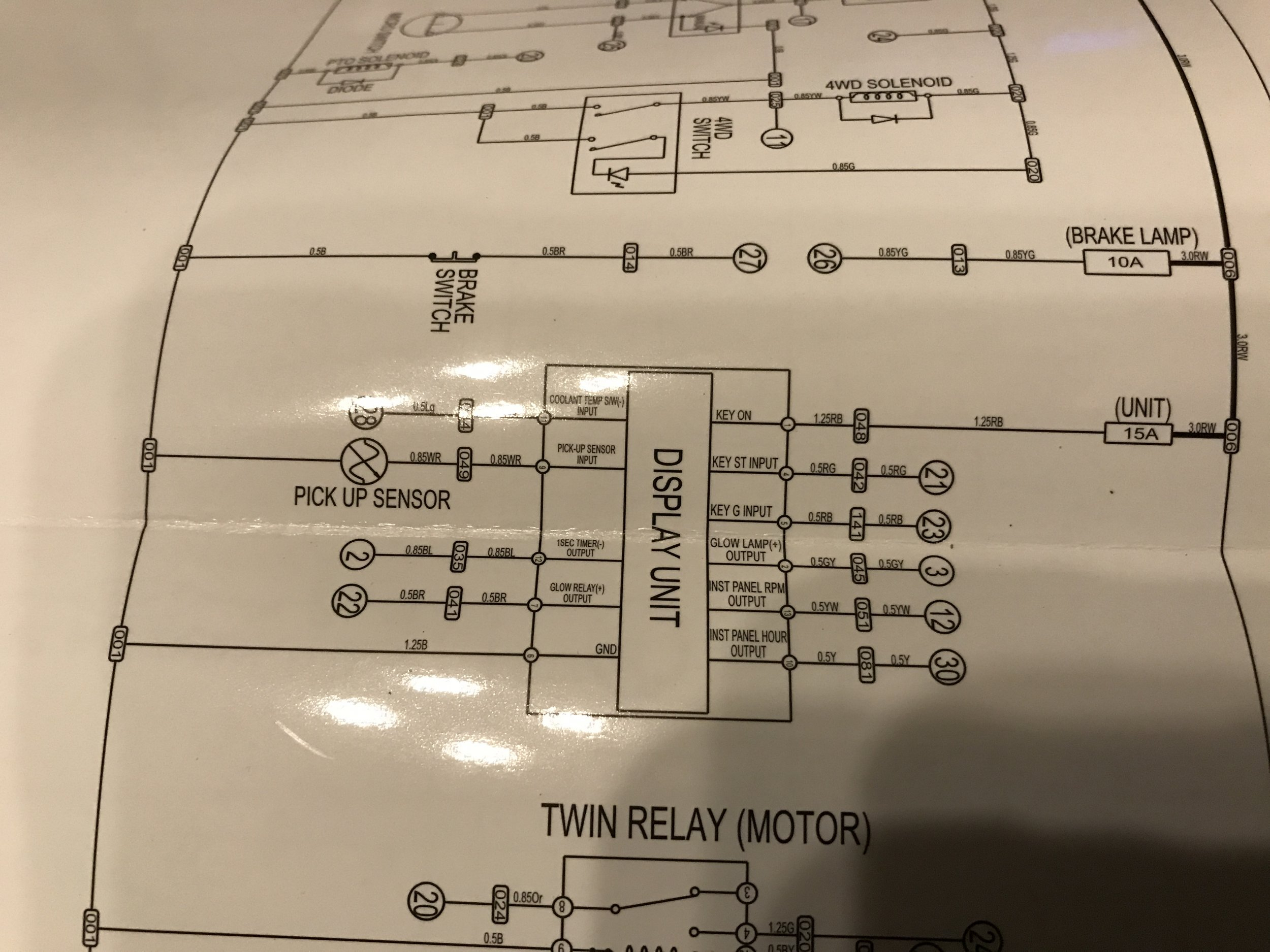

   / DK40SE Won't Turn Off
#18
So the question is, where does the 1sec 12v signal to the pull stop solenoid wire come from? If I can figure that out I've found my problem.
   / DK40SE Won't Turn Off #19

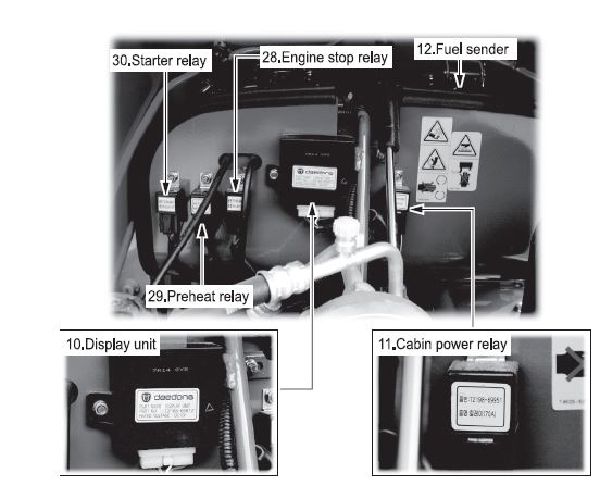

I would look closely at the engine stop relay and the wires going to it.
   / DK40SE Won't Turn Off #20
The 1 second delay comes from display unit
