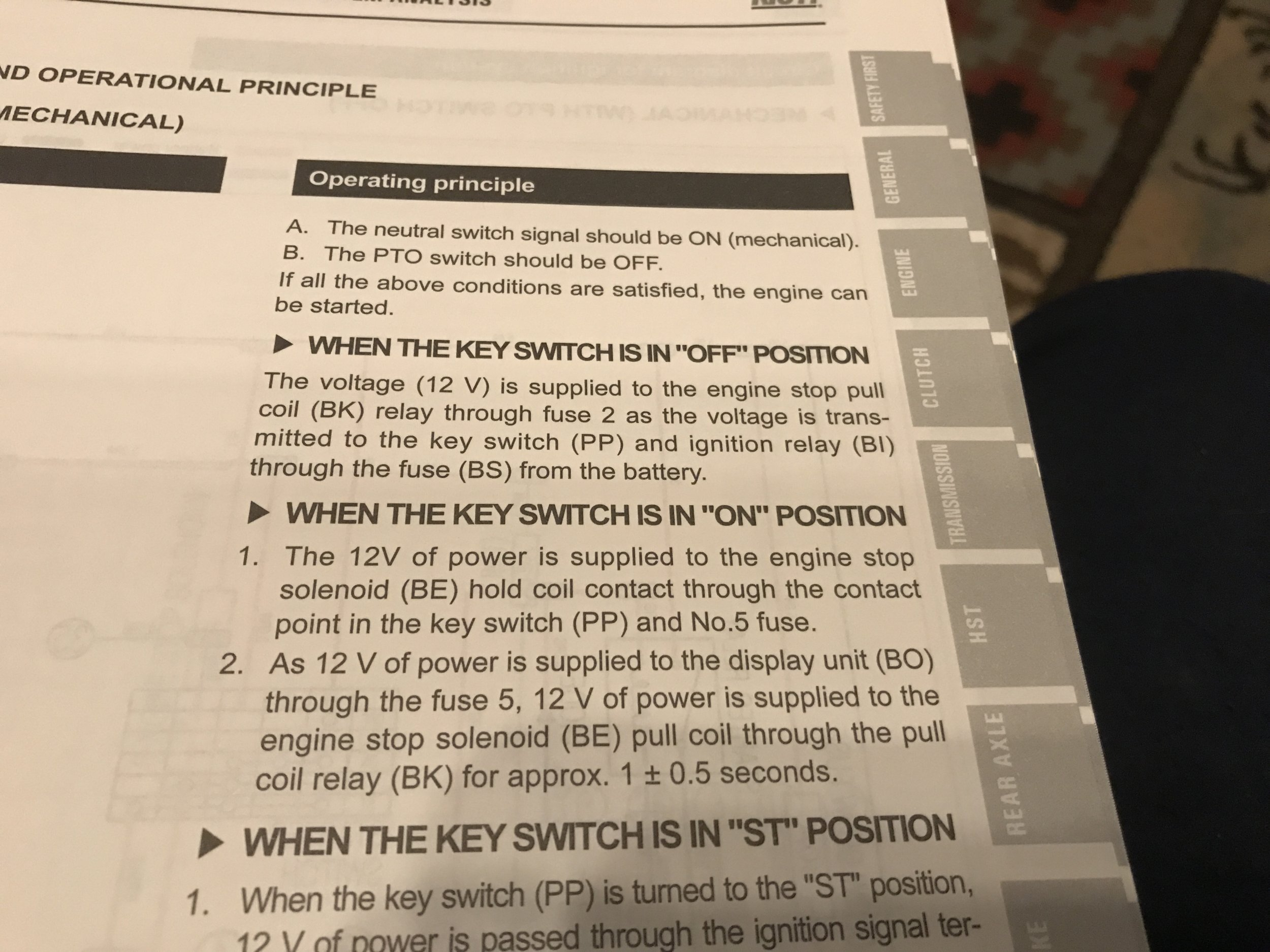

Check fuse 2. Also the stop relay may not be as described above. Mine was a different relay. I found mine by feeling for clicking
the signal goes thru the ignition relay……not sure where that is. But still looking

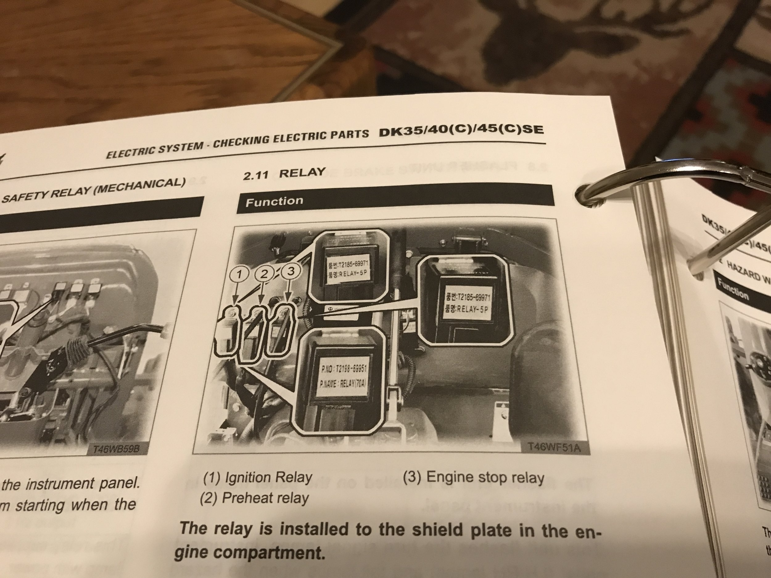

   / DK40SE Won't Turn Off #22
It appears the ignition relay is the same as the starter relay according to this image…..
