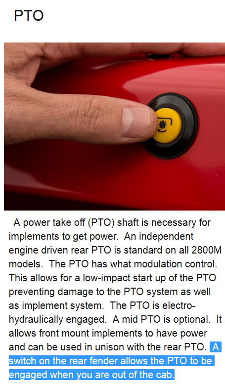

One might argue that it would be safer without someone sitting in the operator station while using stationary PTO driven equipment. The person operating the driven equipment should be the one in control of PTO engagement, not some otherwise idle person sitting in the seat who might accidentally turn it on at a bad time. Some of the new Massey CUTs actually have a remote PTO switch on the left fender for that purpose, great for using a post hole digger, etc... Would be great complement to the DK's remote 3pt hitch lever.
