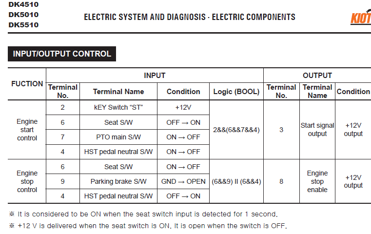

I’m a standard transmission guy - only experience with HST is my Husky lawn tractor. Is there no neutral on the range selector? For the sake of this exchange however, I would prefer to think of that as a hydrostatic brake. If the engine is running, and all you have to do is step on a pedal to get the tractor to move - then can it Really be called neutral?
According to the boolean logic, yes.
&& = "AND"; || = "OR"
Bottom diagram is engine STOP control:
For Manual: IF "seat is empty (off) " AND "parking brake not engaged (open)" > STOP engine
<OR>
For HST: IF "seat is empty (off)" AND "HST pedal neutral SW not in neutral (on)" > STOP engine
Looks like the interlock is not even looking at PTO for the engine "stop" condition, only for engine "start".

So.............. my interpretation of that chart is that there IS an HST neutral position? Correct, or No?
   / DK4510 - running PTO while out of operators station #23
C'mon people..
Butt in seat, in Neutral, foot on Brake (not parking brake), and yes, obviously PTO off = can Start
in Neutral, Parking Brake on, PTO On = can leave seat and PTO runs.
It's not rocket science here..
Yes, there is a Neutral. No, it's not the same as swash plate at zero-pitch while in gear (H/M/L).

This is an email from Kioti Corporate to me dealer - Today!
"All of our current production tractors utilize a seat switch. If the PTO is running , the operator stands up off the seat, the engine will shut down in 3or 4 seconds as the engine is starved of fuel. This is for safety, as it is unsafe for PTO driven equipment to be running when the tractor has no operator on the tractor. Older CK and DK tractors did not have a seat switch, and standing up off the seat did not cause the engine to shut down. Seat switches are now required."
But - the manual says tranny in neutral and brake on ........ for fixed PTO implements .............. kind of confusing.
Seems like it is an engineering oversight to design a machine that won't run: chippers, 3 pt winches, log splitters, etc etc.
Dealer said to me - " we'll just bypass the safety switch" ........... hmmm
It's Liability nonsense. Having said that, the dealer could be lots of trouble by telling you to bypass. He should not tell you that, but yeah, I'd bypass it. I get crazy using my friends AG tractor. When sneaking up on something with the front bucket, I tend to get up off the seat for a better view... Damn engine quits everytime. I don't have this "safety Switch" on my construction backhoe. It is a nuisance
