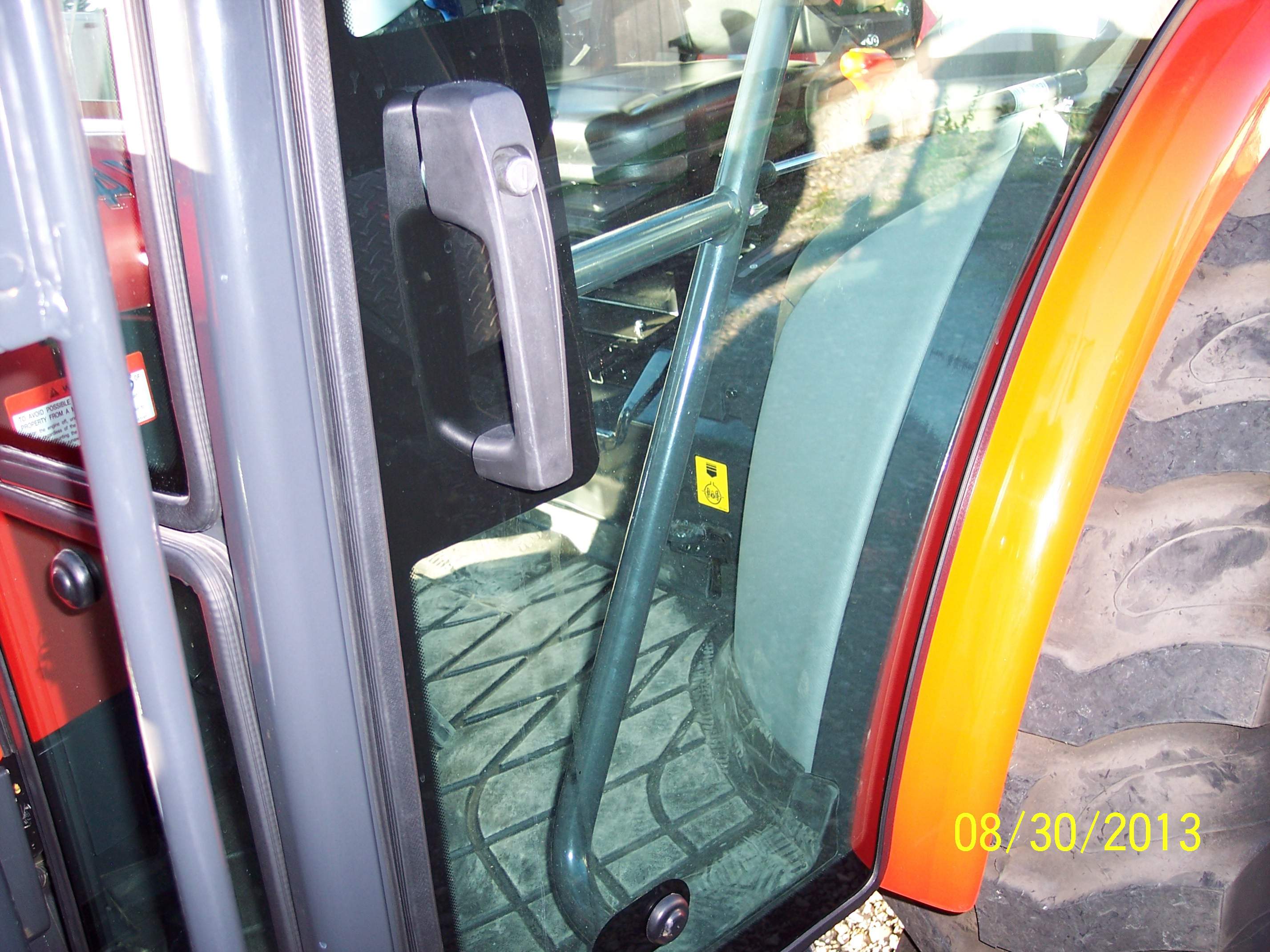

Ouch, I'm sorry to hear it. I to am one of those who won't move an inch without closing the door(s). That hasn't stopped me from ripping one of the work lights and the antenna off the roof of the cab leaving two holes that had to be repaired. I got what I thought was a ridiculous price to replace the roof so I had it repaired. The price you got doesn't surprise me one bit, not that it wouldn't bother me just as much, but tempered glass is expensive. Sorry for your bad luck.
The glass on these tractors is curved with a lot of hardware mounted to it, I don't know if you could just cut a piece of glass for one.

ouch I did the same thing with a fence post. it is amazing how fast it just explodes.. I have bought two doors and a window, but i have to commend kioti on the way they engineered their glass as it installs very very easily. I installed all of my mistakes at the ranch.

I bought my DK50 with a busted out cab window. The seller gave me the gasket which had all of those little pieces of glass stuck inside the recessed groove. I found a easy way to remove the glass pieces by using a flat blade screwdriver the blade the same width as the groove. I'd slip it under the glass between the glass and the gasket then pry the glass up and out of the groove. It took 5 minutes to do the whole thing. I then made a cardboard cutout/template of the window area by tracing the window frame. I found a piece of polycarb and made a satisfactory replacement. It does not have the bubble effect that the real window had but it got the cab closed up and works good enough for farm work.
