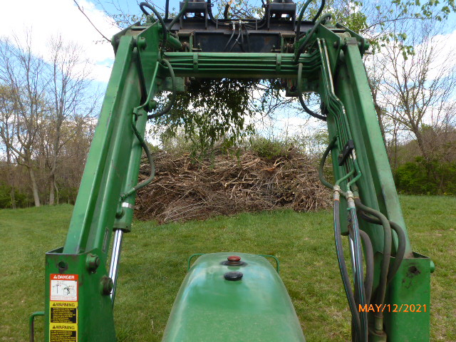

My 80s M5030DT ran two 1/2” hoses from rear remotes to FEL front for grapple. Welded four double hydraulic line mounting blocks to support the lines. Protected the lines in nylon sleeve. Believe the lines were 12’ long. No problems for over twenty years. Newer tractors have factory 3rd function. With hand remote valve you could control grapple grip strength and speed easy. With the factory solenoid valves you have to bump the switch buttons and get more jerky control. Either way was plenty fast and worked well.

MY JD 2030 has two rear SCVs, so it was the obvious choice for my grapple. It (the SCV) has detents for both open and close. Move the lever to detent and do something else while the grapple is opening or closing. Like curl or dump, change directions of the tractor, raise or lower the loader, etc.

Hmmm. wondering what your flow rate is, and how many and how big the cylinders are on your grapple. My cycle time from full closed or full open to the other state is certainly less than a second. My flow rate is about 10 GPM, and I have a single cylinder.

No you don't. my hand stays on the loader control joystick and my fingers operate the SCV. I am guessing you did not follow my thread for extending the SCV valve lever to accomplish that.
I am not saying operating your grapple from the SCV (rear remotes) is a great idea for all tractors, I am saying it is a great idea for a certain line of Kioti tractors like mine. If your rear remotes are by your side some other inconvenient location, it could very well be very inconvenient. With my setup and some others I have seen photos of it is VERY convenient.

I think around 9-10gpm. It has two cylinders, I am guessing 3" bore. I usually shift the tractor to reverse as the grapple opens (no reverser). I leave the clutch down until opened and dumped, then I ready to back away from the burn pile.
