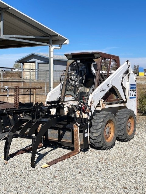

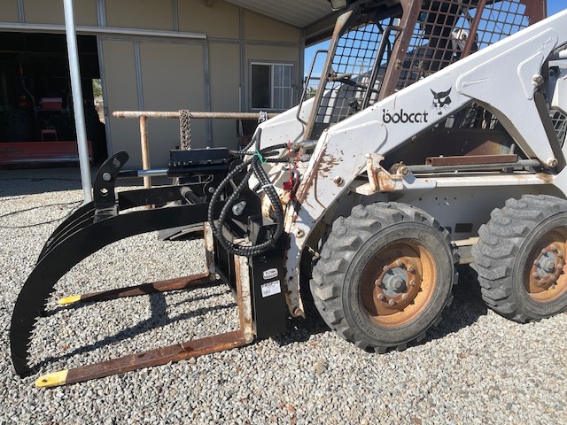

I had an extra set of forks lying around so I bought a SS mount with a grapple attachment without forks. Can't remember the exact cost but it was not a lot of $.
