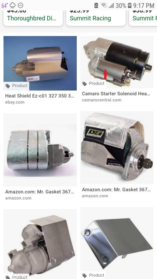

Your dump truck is a chevy right?
Alot of them "back in the day" wouldn't start well when hot.
A heat shield on the solenoid will fix that problem.
   / Do battery cables go bad? #78
Theres about a million different ways to do it. Fixed more than one car that way.
Some guys put a ford solenoid up on the fender. I haven't done that.
The poor little solenoid doesn't like living next to the exhaust manifold. On a hot soak (sitting after running a while) things "soak up" the heat and are hot all the way through.
