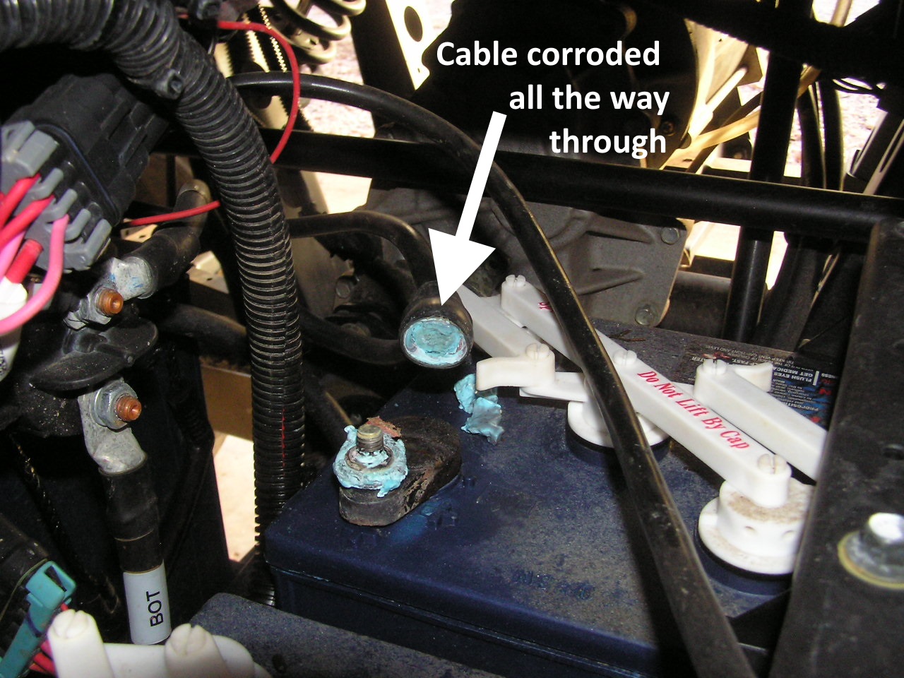

This is the worst that I have seen.
Before:
After:

After only 60 years the battery ground cable on my Ferguson went bad. It had the wires cast into the terminal ends. It still looked good. I needlessly replaced the starter first because I thought the cable looked good and that kind of cable never goes bad. I should have checked to see if it is covered under warranty :)

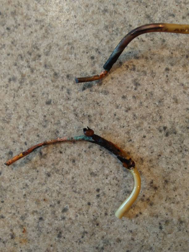

I had a 93 chevy truck that acted like that. The fuse link on the positive cable corroded in half.

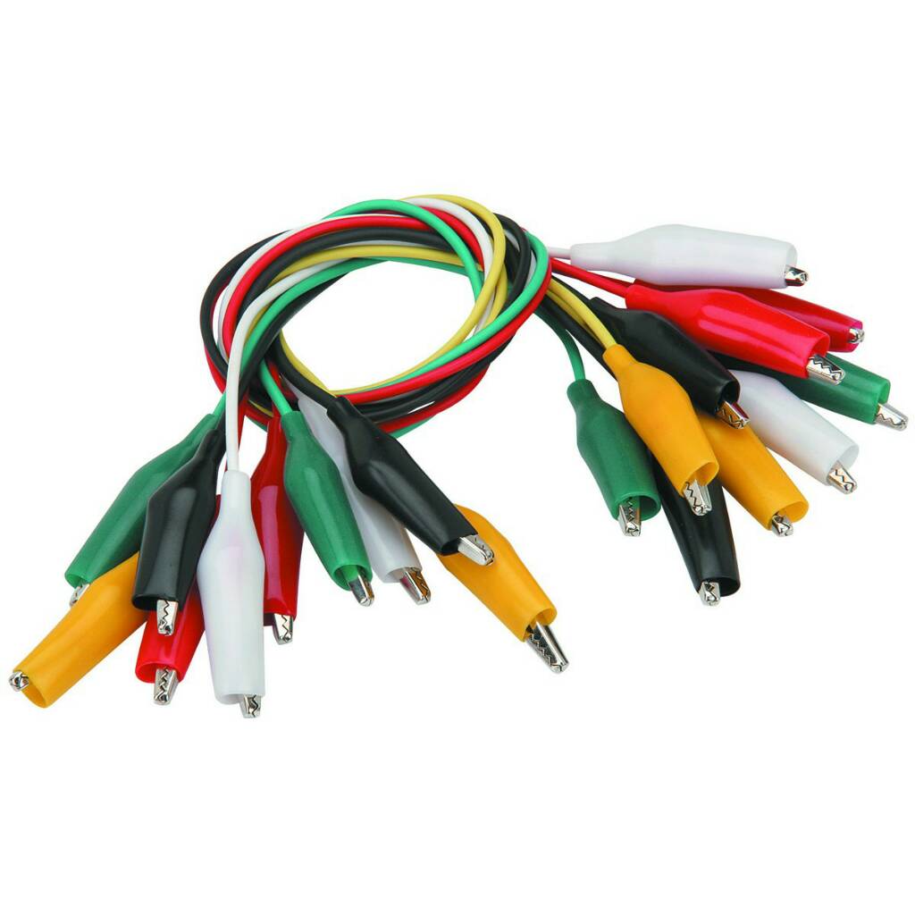

Now...clip leads are useful in that you can clip from starter battery terminal to starter case ground, other end out to voltmeter where you can read it. (Two important points here 1. With wire you can make long leads several feet long, small gauge is fine...you're just measuring voltage and 2. Be 100% sure + lead cannot touch ground!).

I can tell you as a retired electronic technician 43 years wires, cables can and do fail in bizarre ways. A wire can look perfect, looking at the insulated outside and there can be a problem inside, maybe manufacturing defect, movement, etc.
Most wires we use are stranded. One thing that can and does happen is one strand breaks. Now at that point you have resistance (which equals heat). It's like having a length of 10 gauge wire with a section of 14 gauge then back to 10 gauge.
You don't notice at first but over time just like a weak spot in a water pipe it cascades. Another strand breaks, etc. Finally it breaks altogether, snowball effect and no power.
I've found breaks by securely grabbing both wire ends, pull, it stretches and breaks at the weak point.
Yep, Volvo had an issue at one point with a positive cable that would corrode where it ran across the cross member under the engine. Ends were fine, but the middle would be bad.

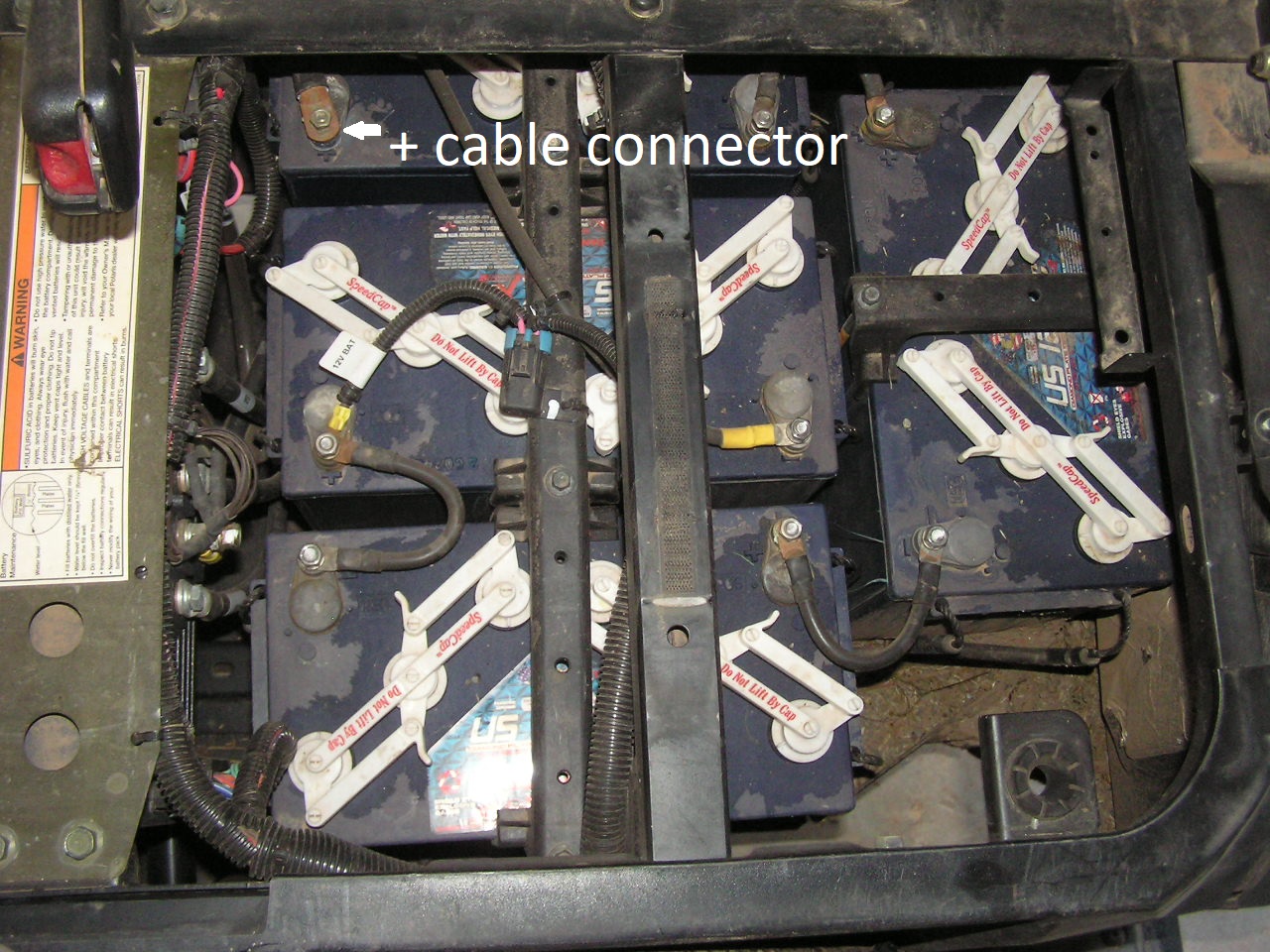

Anyone that has owned an electric golf cart etc. for any length of time can attest to the fact that cast terminals are no guarantee they will not corrode from within...
There are pages and pages of discussions about battery cables on many cart forums...one debate is whether to use heat shrink or not...the latest consensus I recall is that it is best not to use heat shrink...Also, not too long ago here on TBN there was a similar thread about terminal ends for battery cables and the best methods...i.e., crimping and or soldering etc...
