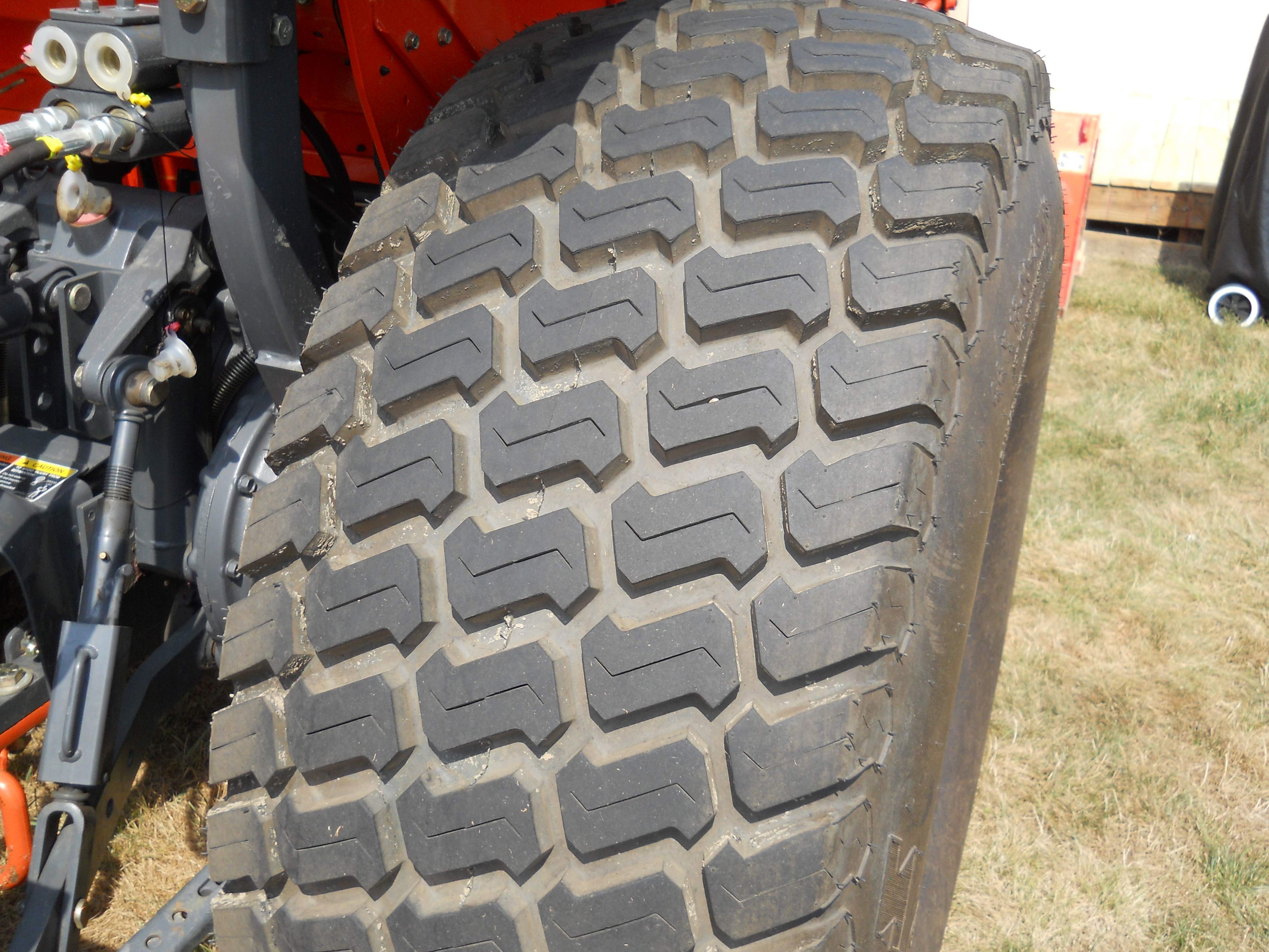

All R1's are not created equal, nor are all R3's or R4's; Joe
Buyer definetly needs to do homework here, like I did. There are many styles of R1 tires available, but usually only 1 type offered by tractor manufactuer in case of CUT's. I cannot comment on R4's, but usually only 1 type offered by tractor manufacturer, in case of CUT's. In the case of the Kubota Grand Lxx40 series, they offer 3 types of turf tires. One type is 'golf corse' type, wide, floatation, not very deep lugs, thin carcus. One type is recangle or diamond pattern, not a good overall tire in my opinion. One type is what I have, very deep tread, many bittting edges, siping. These are Titan Multi-Trac C/S 'The Grizz'. I agree, not all tires are created equal. Philip.
