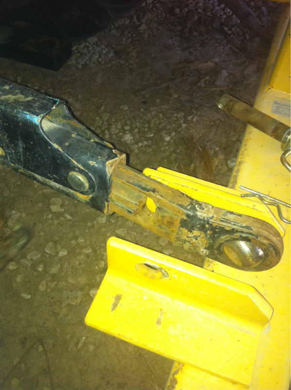

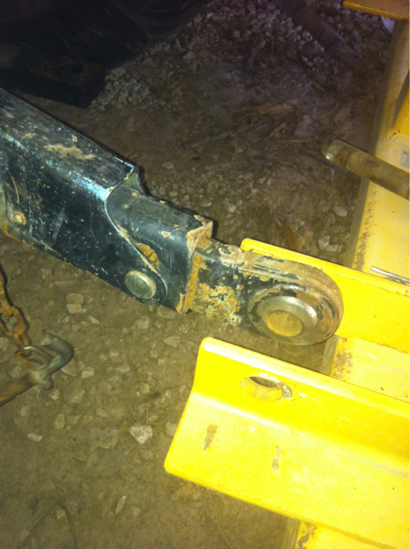

/ Do I need a 3 point quick hitch? #17
How does the top link of the I-hitch / Quick Hitch keep an implement from driving the link off of the bushing? I can see the lower arms have a keeper that lock the lower half in, but nothing on the top link I can see.
/ Do I need a 3 point quick hitch? #18
The bottom holds both if it can't come out the bottom because it's locked in then it can't raise out the top
/ Do I need a 3 point quick hitch? #19
Right, every 3 point attachment that I have seen has rigid frame so that the top pin can't move up or down from the bottom pins.
