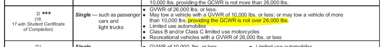

Attached is the NY State rules for whether you need a CDL or not. If you read the class D (regular drivers license) info you will see you may operate any truck and trailer combination up to 26,000 without a CDL or need for a DOT card.
Your state may vary and most have similar info to this on their sites.
Can you show us where it says that.

class d.JPG The snip is from the class D license.
I think were most people are getting confused is the need for the correct class license and the need to follow the federal regulations that govern commercial carriers.
One still needs to get the correct class license to drive your vehicle, however if not used in commerce you would not need to follow all of the other regulations that apply to commercial vehicles.

I like the flowchart you provided. It does state that recreational vehicles for personal use are exempted. Were you meaning something else when you said "The CDL requirement does not matter if it is for personal use or business." I believe the OP said his equipment was for personal use, but it certainly is not a recreational vehicle. How does that come in to play?
Also, I like how the top of the document cleary states that Class A, B and C licenses ARE CDLs. Of all the reading I have done, I kind of figured this was the case, but this is the first time I saw it explicitly written. So saying you don't need a CDL but you do need a Class A makes no sense to me. Am I missing something here? (I see/hear that statement too often in discussions.)
Sorry poor wording on the CDL statement, what I should have said instead of CDL requirement is that you still need the correct class license to operate your vehicle. It is just personal use you are not required to follow all the other rules as I previously stated.

Your 'snip' says nothing about who does or does not need a Med card.

PA's has the same requirements as NY. It shows in the link you posted that a class A is needed for over 10k trailer IF the GCWR is over 26k. That is the same the federal standard. So the OP can tow his rig with a B, C or whatever the standard license is.
