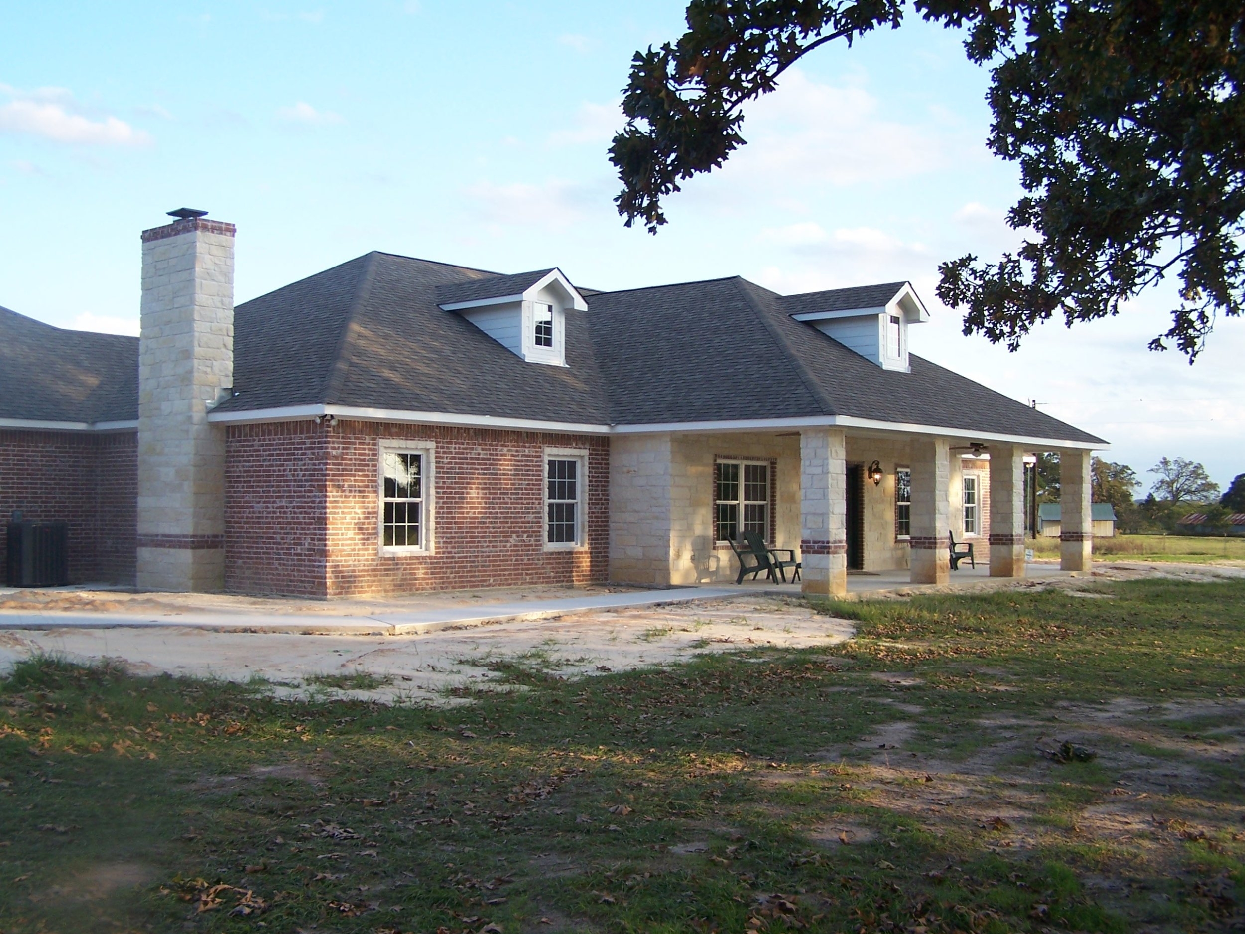

The house we built here - a double wall PanAbode. 100% Western Red cedar - out of Redmon, WA. EXACTLY like assembling a Lincoln log structure - only is double walled. Foil backed urethane insulation fills the four inch space between the walls. Exposed beam throughout the house with four inches of foil backed insulation under the shingles on the roof.
We ( myself, wife & son ) did everything except the foundation and carpeting in the living room. Took us five months.
That was 1982 - when we came down from Alaska. House has require no repairs in those 42 years.
The house isn't that big - 1600 sq ft - just right for our retirement.
