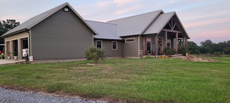

I self contracted my home and moved in 5 years ago this spring. It took 12 months and there was a bank involved. The good thing about having the bank involved is that there was a deadline for getting it done, so I was less likely to slack off. I did my own electrical, painting, and a few other odds and ends. Before I started, I did a lot of research. I had a really good idea of what my costs were going to be, down to the LED light bulbs that would be used. Planning on new appliances? Include them in your numbers. Doing high end appliances in your kitchen? Include them in your numbers, and so on. Make sure that you have a contingency built in. It's better to come in under budget than to exceed it. If you are financing, have all of your homework organized in a binder before you meet with your banker, and make it easy for them to give you a yes. Banks really don't like self contracted homes most of the time (at least that was my experience).
FWIW, I am a die hard DIY guy. I make my living in IT, but my passion is my family, property and animals. I'm not involved in the trades, but I know people that are. With their help, I was able to put together a crew of great subs that with only one or two exceptions, I would love to hire again if I were to ever build another house. So, do your homework and dive in is my suggestion!
