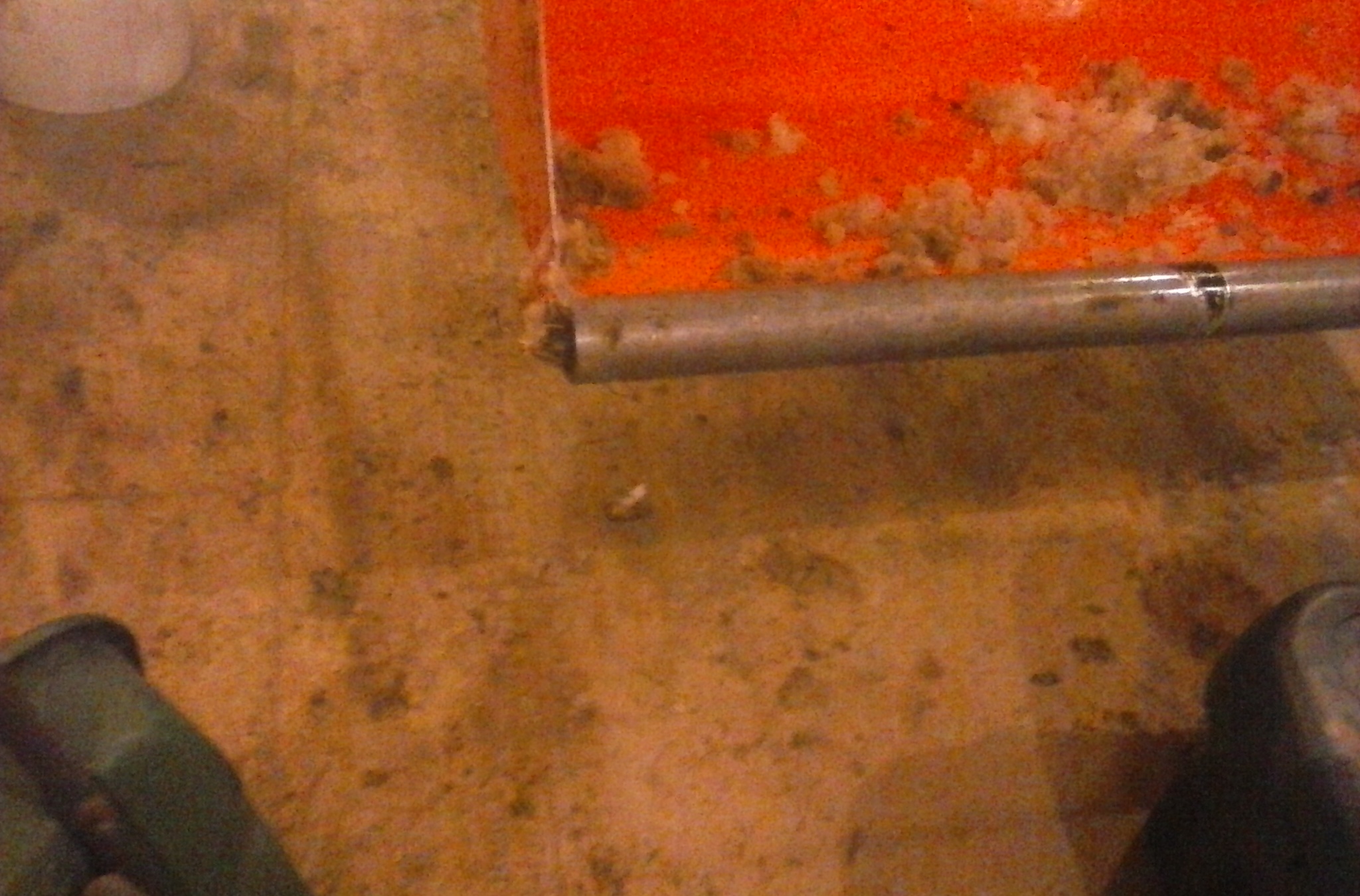

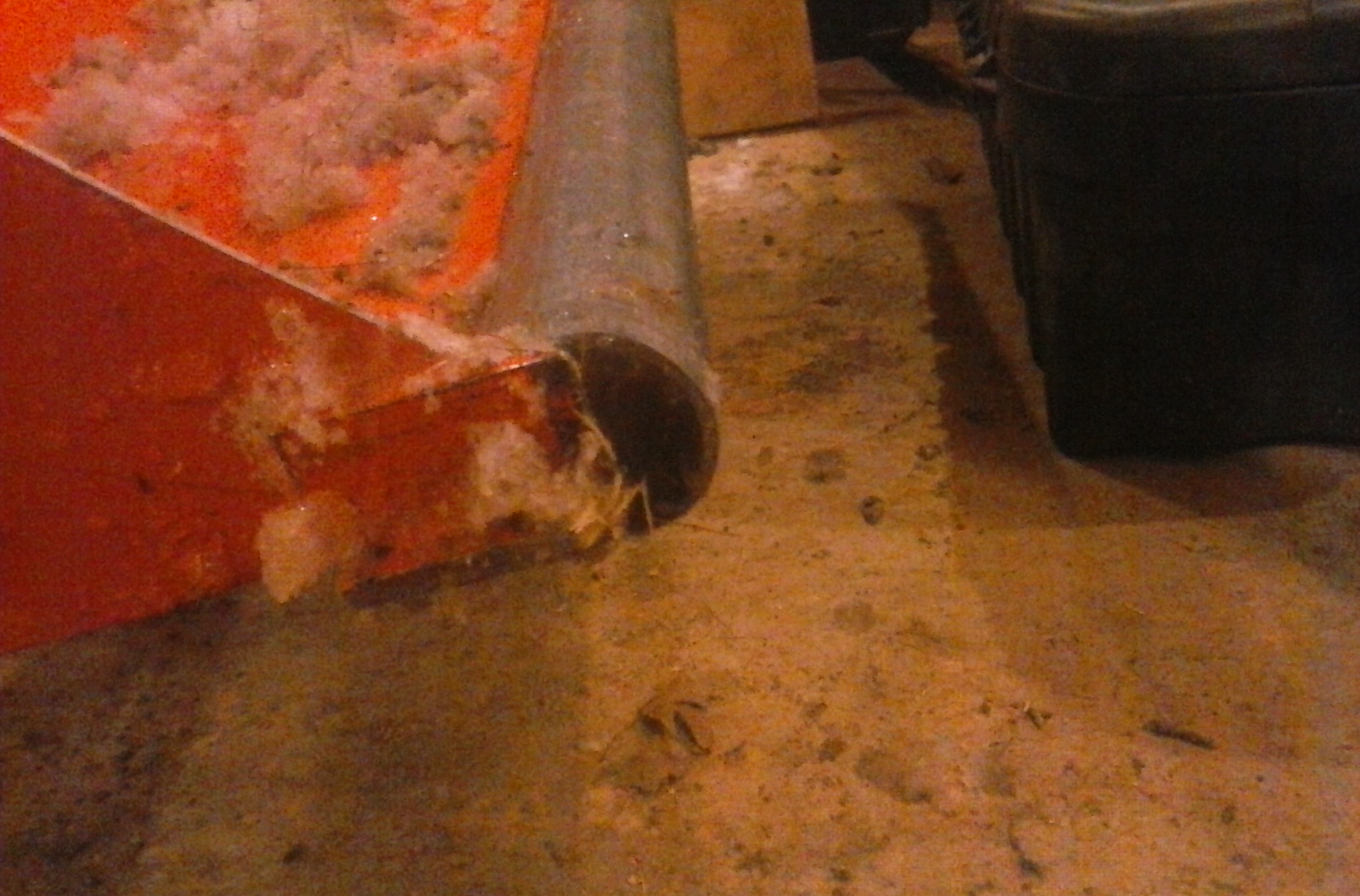

Can you please post a picture of you 2 1/2" split pipe you use. I'm curious.
Thanks
Here you go! I just drew a straight line down the length, took the sawzall to it, then just get a BFH and pound it onto the edge of the bucket!

Your a genius - who would have thought of that? :cool::D and I even happen to have a chunk available. :thumbsup:
Sorry but I can't take credit for the idea...saw it on TV when some little league team used PVC on plows mounted on ATVs to clear a ball field. Look on GOOGLE and you will see lots of other applications. Some people add some brackets to hold it on but it's pretty tight on mine. If it loosens, then I'll add some angle iron on the ends such that they can be bolted to the bucket. Have fun!

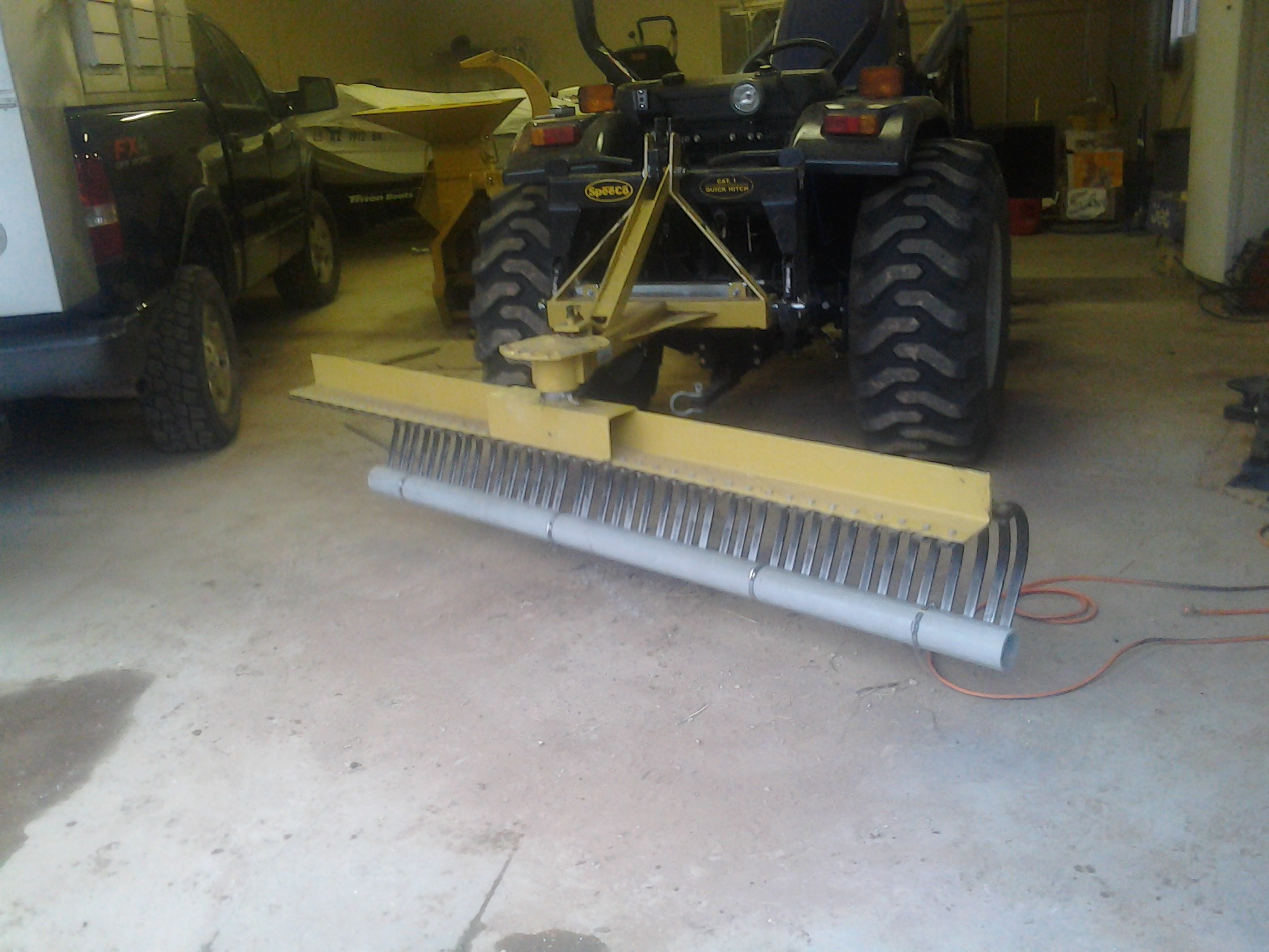

That is cool, I did the same to my landscape rake with a heavy duty pvc p1121161558a.jpgipe.

That is cool, I did the same to my landscape rake with a heavy duty pvc pView attachment 492837ipe.
I started out using the PVC but when it's below 32 deg. it tends to break. But it worked fine until I hit some really hard ground/pavement. :eek:The PVC was not strong enough to stay on when I back dragged as well. That pipe's not moving! :thumbsup:
