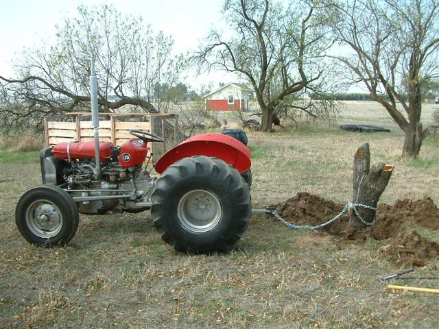

Hillside property--you have to get the correct tractor type if you plan to work efficiently and SAFELY on slopes. Tractors are meant for work on level ground and gentle slopes. You'd be surprised how easily and quickly you can get into trouble running your tractor on a steep slope.
You want a tractor with a low center of gravity and wide wheel track.
Ideally you want your tractor to resemble my 1964 MF135 diesel. It's a straddle tractor (you sit in the seat with your legs straddling the transmission) that has 16" diameter rear rims and 18" wide rear tires so it has a very low center of gravity and a very wide stance. The rear axle centerline is only 16" above ground and the distance between the outer walls of the rear tires is 84". The front axle spindles are shortened to keep the tractor level. The wide rear tires are 2/3 filled with water (no danger of freezing here in CA's North Sacramento Valley).
That 135 has been pretty extensively modified to squat low and wide (the previous owner used it to mow and disc his olive orchard). You definitely will not find anything like this new sitting on a dealer's lot. You can modify any tractor you decide to buy into this configuration. I know of dealers who have done this type of modification at relatively low cost.
