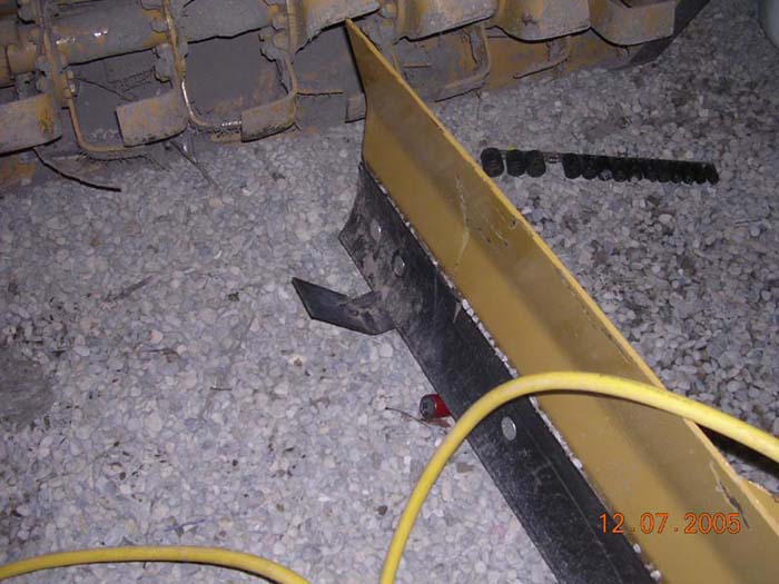

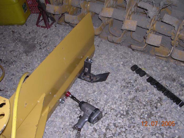

Here are a couple pictures of the shoes on my rear blade. They did cost over $100, which at the time I thought was a bit much.
I just put the blade on yesterday just in case we received a plowable snow, but it looks like we won't be getting enough to worry about.

   / Do I need skid shoes? #23
Picture #2 (a close up).
Notice that the shoes are adjustable for height by loosening the bolts and moving the shoes up or down.

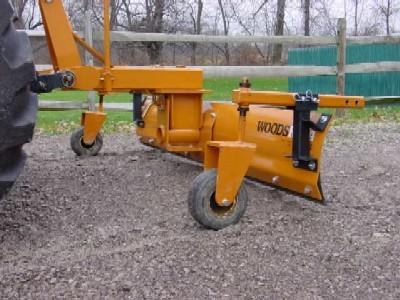

   / Do I need skid shoes? #27
Here's a pic of my guage wheels. I shelled out for a can of spray paint for these brackets /forums/images/graemlins/grin.gif Like I mentioned earlier, they were adapted from my landscape rake, which is also a Woods. They are reversible or come off easily if needed with hitch pins.

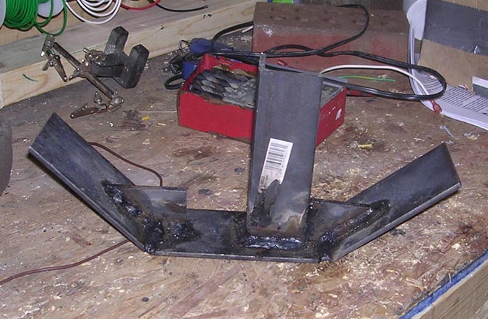

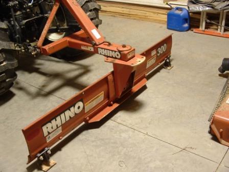

   / Do I need skid shoes? #28
I bought a 6 foot blade about a week ago for plowing snow. I too found that it was digging into my gravel driveway. I decided to build my own skid shoes. I stopped at Lowe's tonight and bought some flat steel stock, then after 3 hours of cutting and welding I now have these shoes on my blade. first a shot of the shoe itself after welding but before mounting:

   / Do I need skid shoes? #29
next a shot of the shoe as bolted onto the blade:

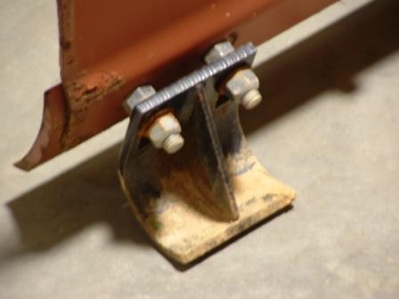

   / Do I need skid shoes? #30
finally, the front side of the shoe. I have not tried it yet, but we are supposed to get 5" of snow tomorrow!
