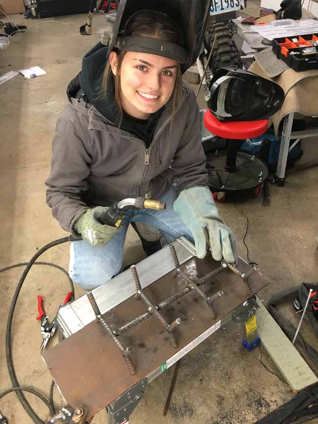

Here's teaching an 18-year old to weld (making a log grate for the woodstove).
This is her first time welding with about one hour of 'assistance' ( I am NOT a pro welder ).
I bent the rebar and she welded.
Those welds are using gas (not flux-core).
The grate is in the fireplace now.

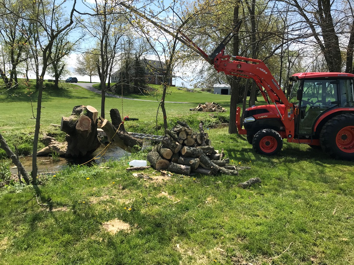

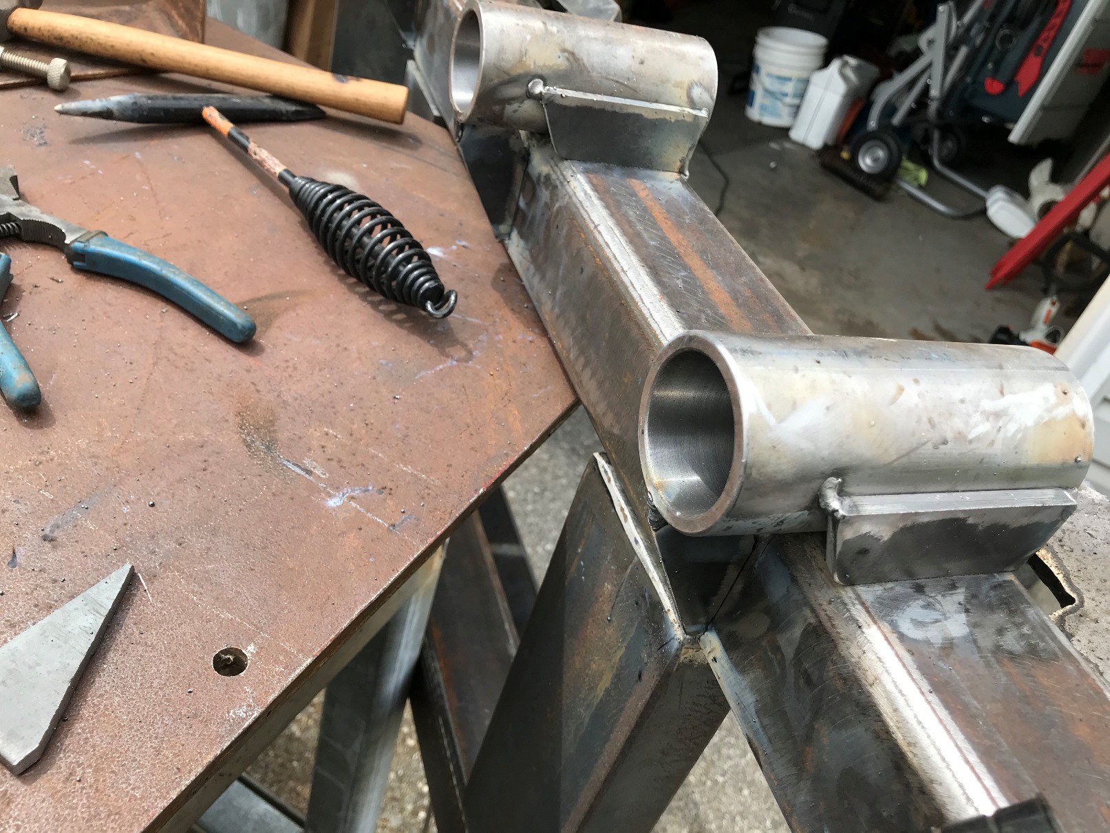

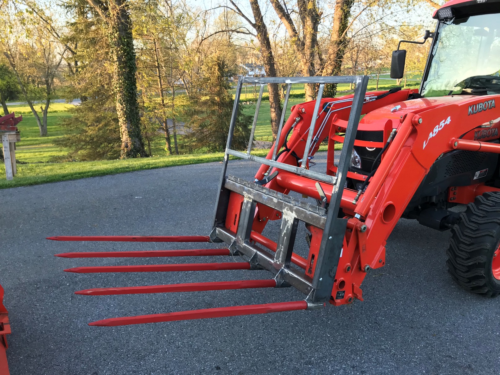

I don't visit this part of the board very often, but can tell you my experience as a wannabe weldor. From the 70's till about 10 years ago my welding was all done with an old AC Lincoln tombstone at the in-law's farm. Then I splurged on a Millermatic 175 and a gas bottle. Most of the time I use fluxcore wire because I don't have a safe place to weld indoors. The one big exception was when I took the machine to work for a couple months to build a cab in my spare time.;
Anyway, the guys who weld for a living at our shop helped me pick the machine and it's been very handy. I ran a 240V dryer outlet to the garage and have a 10ga cord so it can be used outdoors. The strength of the welds has not been an issue. Here are a few pics of a recent project. The very rugged QA frame for the brush forks was found cheap on Facebook Marketplace. I added a headache rack and a couple 4" channel stiffeners just in case.
The fork times are 48" bale spears. The internally tapered bushings are welded to the bottom of the frame. I didn't trust relying on welds where the radius of the bushing meets the flat of the bottom tube, so I cut some pieces of plate to catch them at 9:00 and 12:00. Then made triangular gussets to catch the front of the bushing where it protrudes past the frame.
I had some lifting that was too far for the FEL, so I rigged up a pipe for extra reach. The ends of the pipe deformed from the pressure and essentially shortened it a tad. That caused the two chains carrying the load to slack up and the weight on the end of the pipe pulled the spear down somewhere around 6" at the tip. Following that my nephew was helping me with another tree and a large section of the trunk was stubborn. A different spear deflected about the same amount. Surprisingly the welds held up just fine and the spears sprung back to their original shape.

Have you had that fork setup long?
Need to make a set of forks for the front of our tractor and I'm planning on using bale spears like that, but wasn't sure if I could get away with them on the bottom (probably welded to a piece of 4x4 tube, or a piece of heavy C channel) or if I needed to go through the plate.
